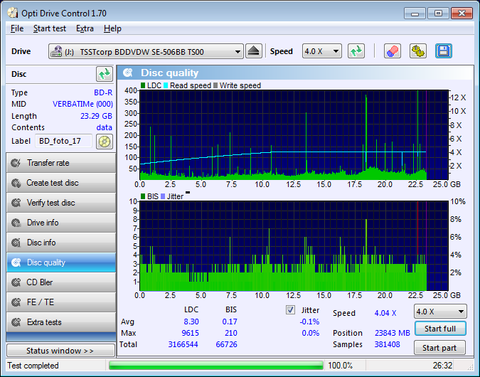

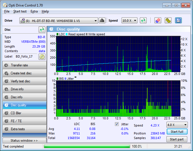

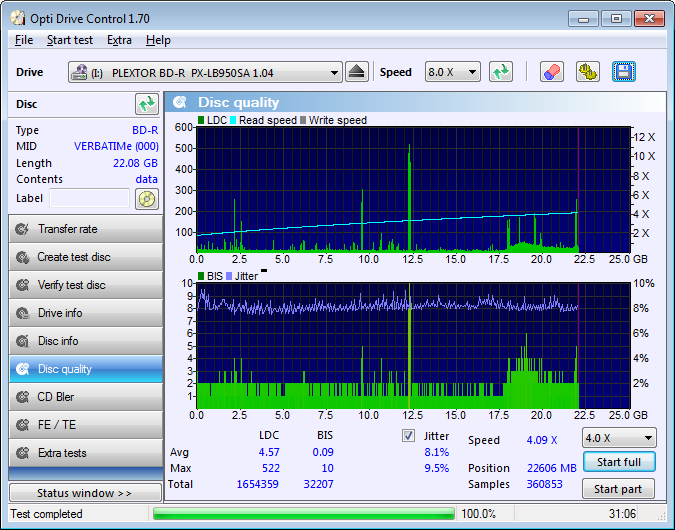

  • Verbatim BD-R 25 GB x6 (VERBATIMe) made in Taiwan
  • Samsung SE-506BB TS00
  • ImgBurn 6x, OPC on
Samsung SE-506BB-_se-506bb_6x_bd-r_verbatime_-000-_plextor_bd-r__px-lb950sa_1.04_04-lutego-2018_03-38-1-.png
Samsung SE-506BB-_se-506bb_6x_bd-r_verbatime_-000-_hl-dt-st_bd-re__wh16ns58_1.v1_04-lutego-2018_02-49-1-.png
Samsung SE-506BB-_se-506bb_6x_bd-r_verbatime_-000-_tsstcorp_bddvdw_se-506bb_ts00_04-lutego-2018_01-23-1-.png
Samsung SE-506BB-bd_foto17_bad_se-506bb_6x_verbatime_tsstcorpdvdwbd_ts-lb23d_sc02_04-february-2018_09_31.png
