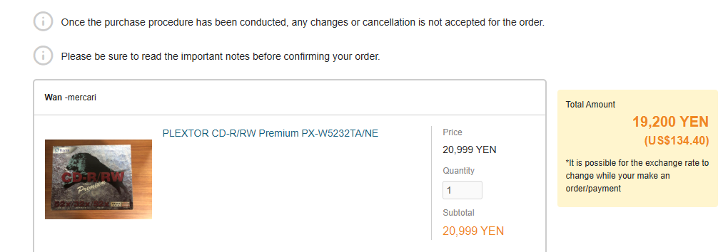

NightRanger 01.08.2025 16:34
Napisany przez Stingray (Post 1474228)
did you see japan market? right now I see new (old but not used) premium 1 for about 135$ ( with a discount)
thanks, but the point was to try to buy a "cheap" broken premium and then repair it ;)
Stingray 01.08.2025 14:15
NightRanger
https://i.postimg.cc/zvxgx16D/p1.png
