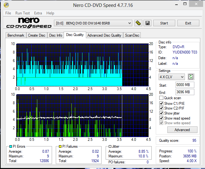

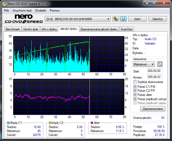

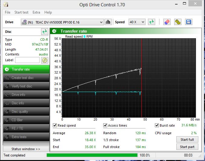

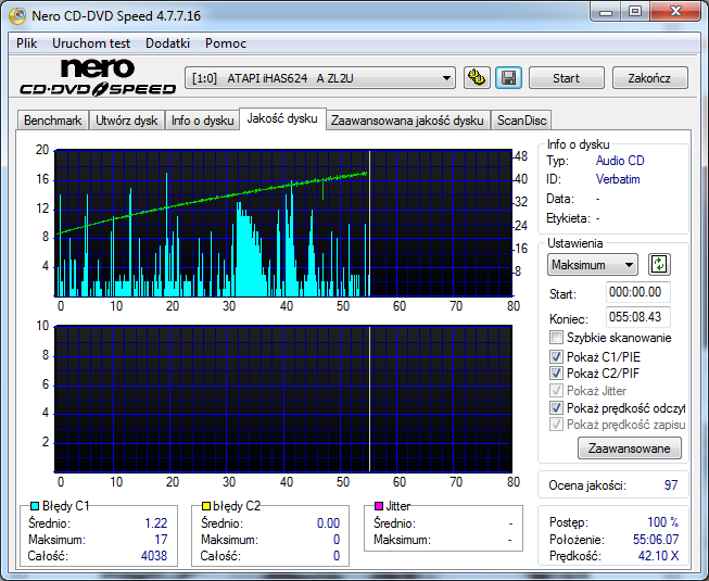

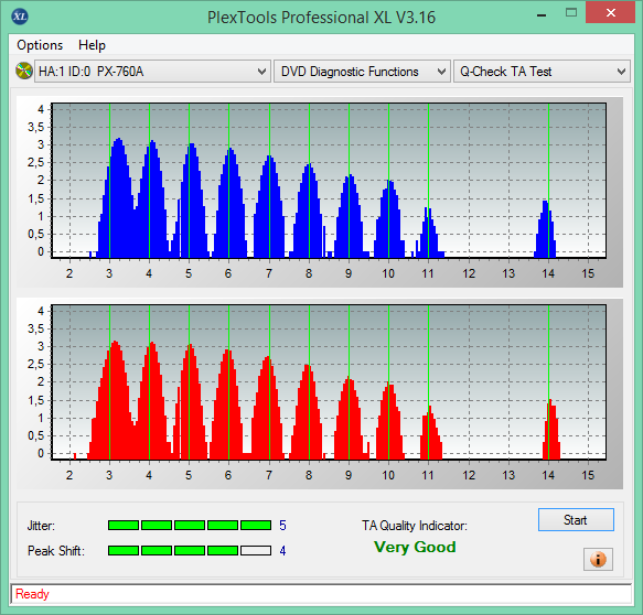

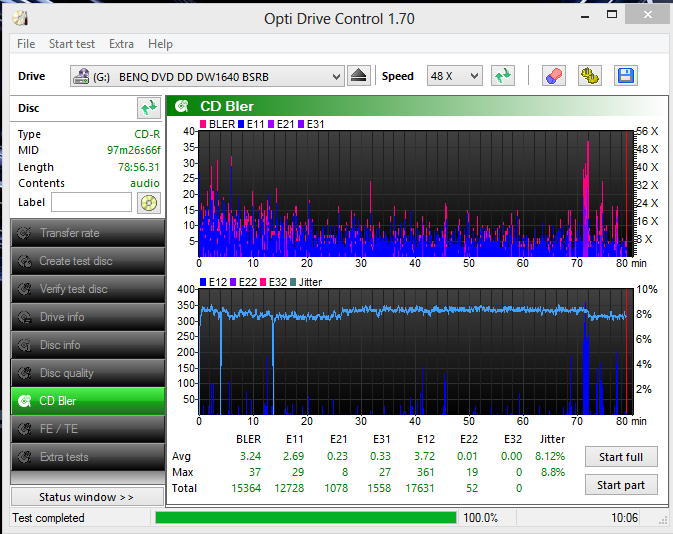

czary2mary 13.06.2026 12:30
Ilość załączników: 2

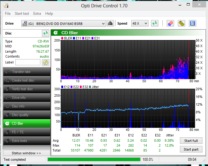

RITEK CD-R Inkjet White Medical 52x MID/ATIP : 97m15s17f
Teac DV-W5000E PP 100 fw.E.16
ImgBurn x 16
Załącznik 217906
Załącznik 217907

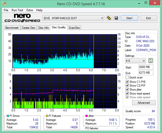

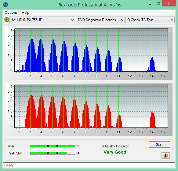

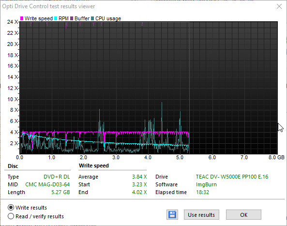

czary2mary 11.11.2022 10:14
Ilość załączników: 4
HP DVD+R DL x8 MID: CMCMAGD03.
ImgBurn 2.5.8.0 x4
Załącznik 194684
Załącznik 194685
Załącznik 194686
Załącznik 194687

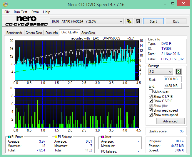

czary2mary 21.01.2022 10:46
ImgBurn 2.5.8.0 x4
Załącznik 183875
Załącznik 183876
Załącznik 183877
Załącznik 183878

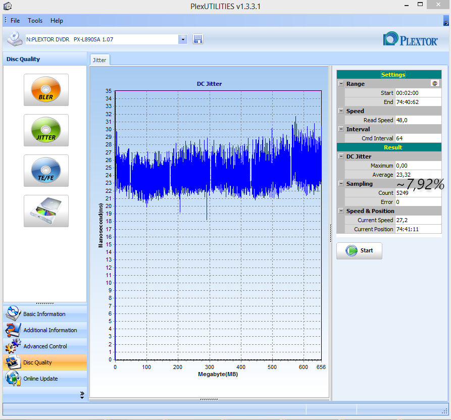

czary2mary 10.06.2020 14:24
Ilość załączników: 6

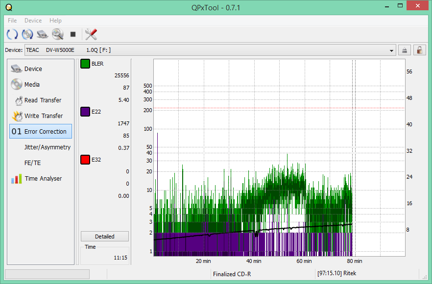

CMC Pro-Primera CD-R TuffCoat 97m24s01f
Teac DV-W5000E PP100 fw.E.16
ImgBurn 2.5.8.0 x10
Załącznik 158538
Załącznik 158539
Załącznik 158540
Załącznik 158541
Załącznik 158542
Załącznik 158543

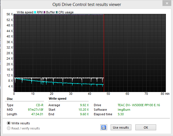

I mainly tested Epson PP 100 models which do not work properly and perfectly on every computer hardware.
Check on another program like Opti Drive Control test recording - the program has problems with test recording on NEC \ Renesas chipsets, hence this problem with write speed.

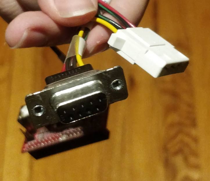

I very recently picked up one of the medical drives, this one apparently from a Siemens Acuson S2000 ultrasound, for what I think is a pretty fair price (serial redacted).
Even came with an IDE-USB bridge (Cypress chipset as usual) and a strange DB9-to-Molex power connector, which I'm assuming is used internally in the ultrasound machine.

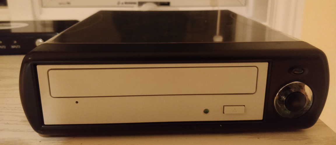

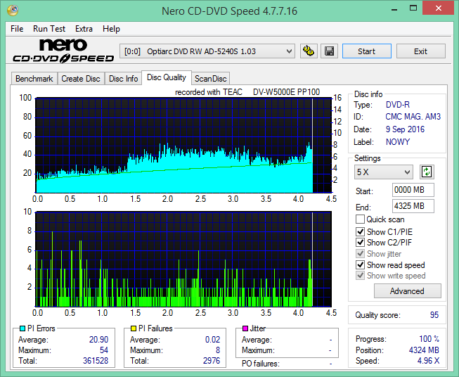

bilditup1 27.05.2020 08:47
DV-W5000E G.1A
Ilość załączników: 9

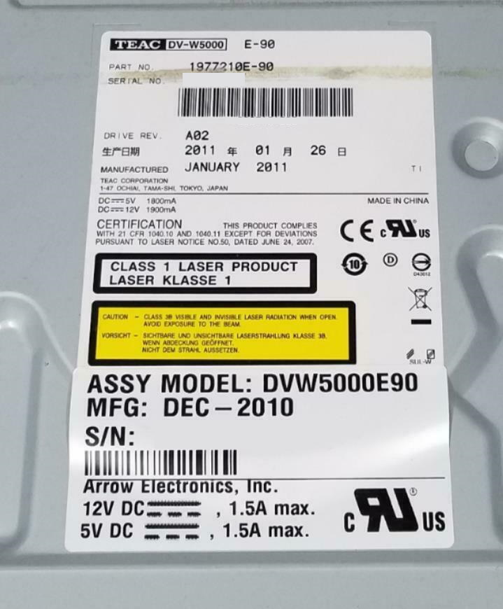

Załącznik 157726
Załącznik 157725
Front is as plain as they come, no markings at all, and even eject button is tiny. (Put in enclosure as it's too rare to just use naked, haha.)
Załącznik 157724
Came with firmware G.1A (attached w/kernel, see bottom of post--dumped using DVRtool 1.02) which I haven't seen attested to anywhere (I'm assuming it's one right before H.0P).
Załącznik 157727Załącznik 157728
(serial in above screenshot is redacted)
So far only have made one test burn, with mediocre results (though this media has mainly been mediocre-to-ok for me, will be posting more about it later/elsewhere).
CMC MAG. AM3
WinValue DVD-R 16x, branded
Made in Taiwan
Purchased early 2019 at MicroCenter
ODC 8x (eff. ~1.8x)
Other notes: cheapest DVD SL media I've ever bought at $7 US/50pk.
Załącznik 157729
Reads OK...
Załącznik 157730
but, well...
Załącznik 157731
...which is something I very rarely/don't think I've ever seen, except when there was a problem with the disc scan itself (and I've never had such a problem with this drive). Will try to run it through other ones (which I usually do, was in a rush this time) but would be surprised if it changed much.
Also did not do so well at secure cd ripping (fast, actually quite fast, but a few problem sectors that ripped fine with other drives) but apparently this is typical of drives with an NEC chipset :/
Any case, will try to do some more testing soon. I'm curious about trying 1.0Q, H.0P, and possibly the Pioneer FWs with this drive (was actually wondering why this is usually done with 216, rather than 117 like in the above screenshot) though the ones specific to the DV-W5000 don't actually seem to be up anywhere, not even here, unless I'm missing something...

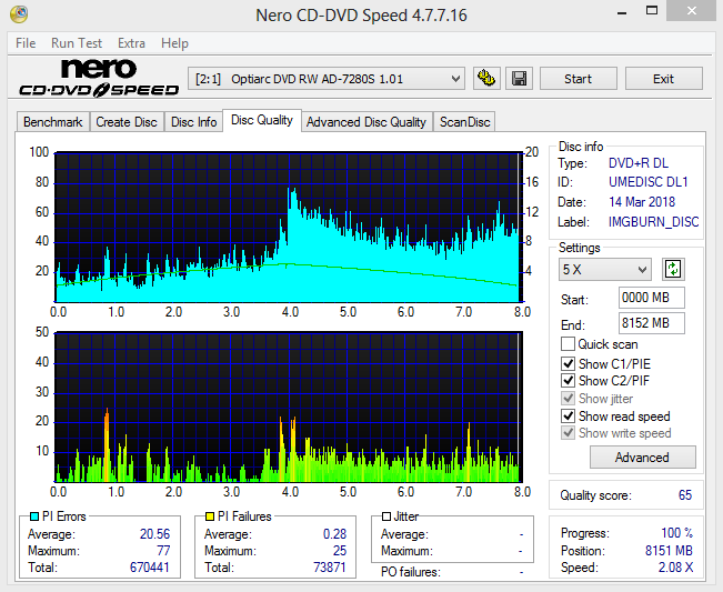

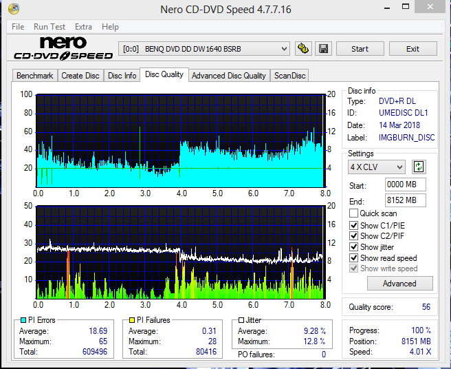

czary2mary 30.03.2018 06:28
Platinum DVD+R DL MID:UMEDISC DL1 UmeDisc China
Teac DV-W5000E fw.1.0Q
ImgBurn 2.5.8.0 x2.4
Załącznik 117570
Załącznik 117571
Załącznik 117572
Załącznik 117573
