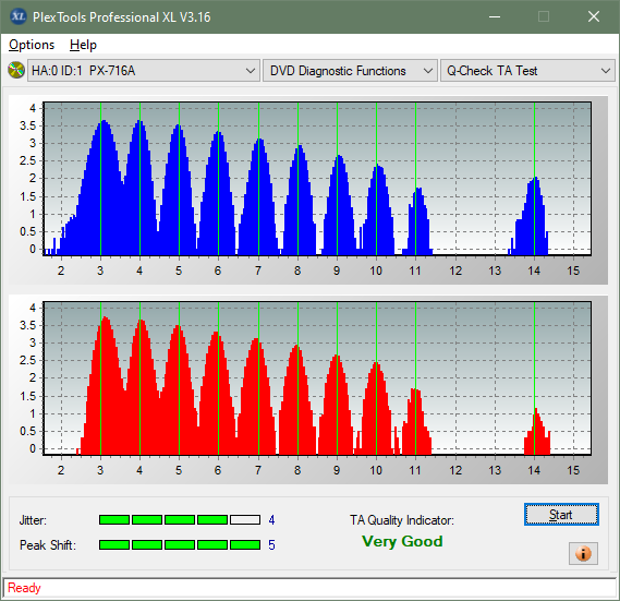

1Tester1 31.08.2026 22:17
Smartbuy DVD-R 16x
RITEKF1 (Made in Taiwan)
PLDS DVD+-R DH-16ACS JD11
As expected, better result ;)
But I scan since 2013 with LiteOn DVD-writers @8x, to make it comparable with my other scans I need 8x :)
To bad the LiteOn don´t support scan with CLV or P-CAV (like Benq)
Was only a quick test. my normal scanneer since some years is a iHAS 324F

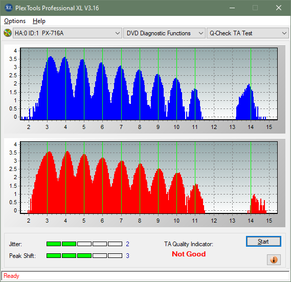

misiozol 31.08.2026 20:06
Napisany przez 1Tester1 (Post 1479278)
Drive gets recognizes as PLDS DVD+-R DH-16ACS JD11
Made a test burn and scan to test this drive
Smartbuy DVD-R 16x
No additional settings/tunings
make same test but now 4x speed ;)

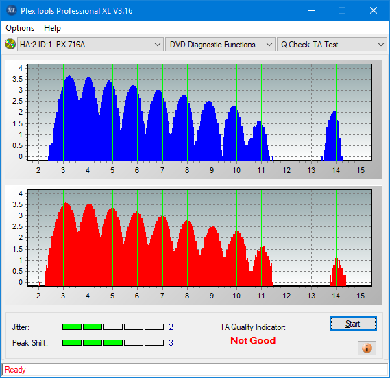

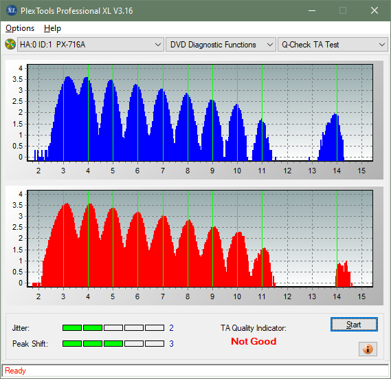

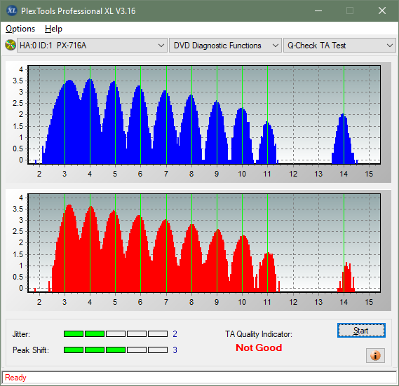

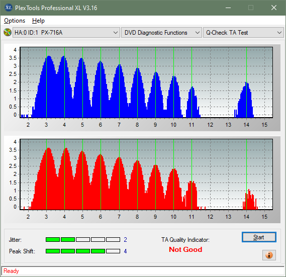

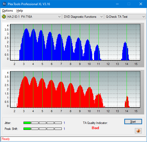

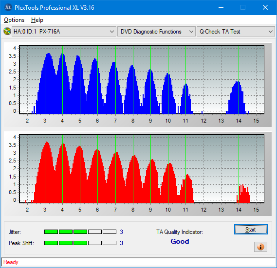

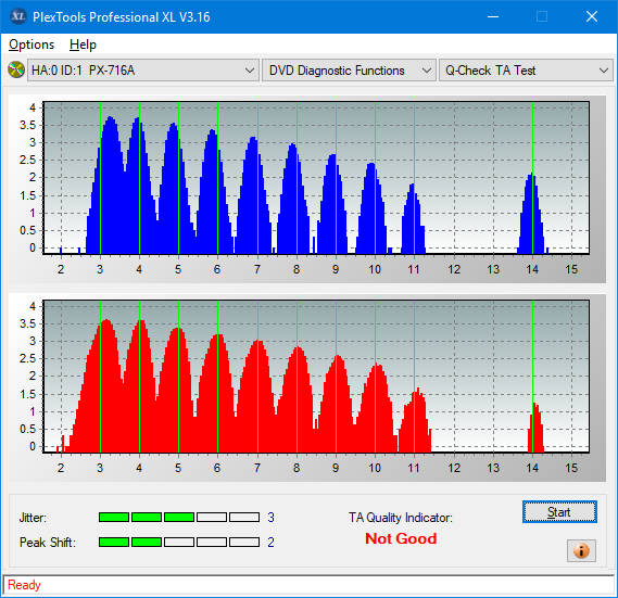

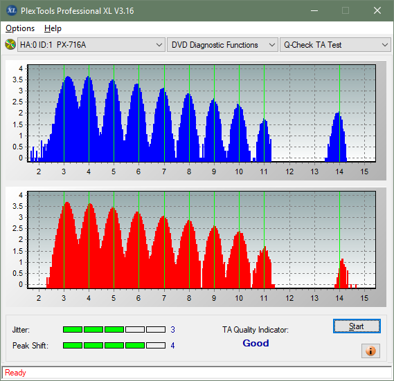

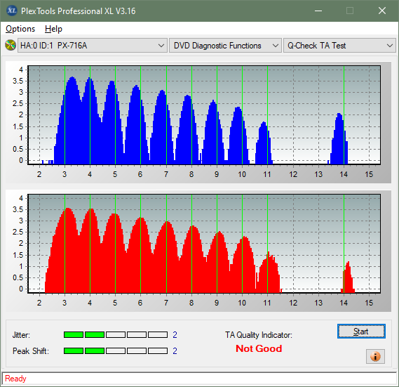

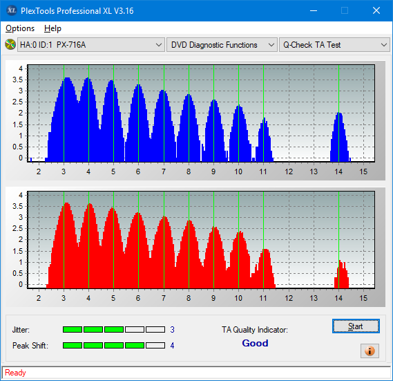

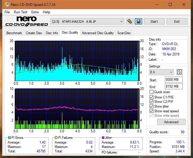

1Tester1 31.08.2026 17:03
Ilość załączników: 2
Smartbuy DVD-R 16x
