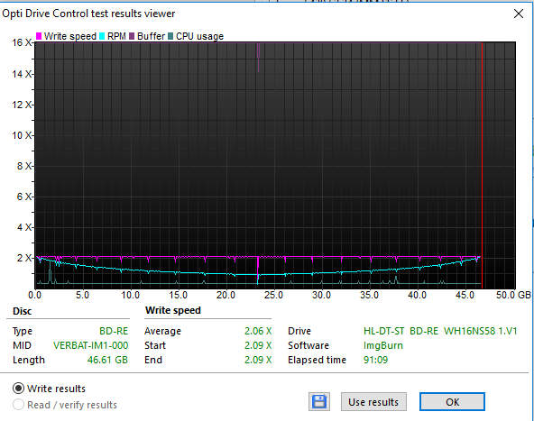

Stary 06.08.2017, 21:14   #6
Posty: 22,828
Nagrywa BD-RE DL na 100%
