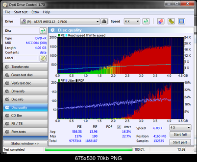

LiteOn iHBS 112/212/312-disc_quality_14-maja-2017-x-data.png
File Type: png Disc_quality_14-maja-2017 x data.png (70.5 KB, 295 oglądane)
