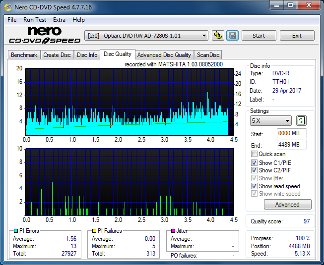

FalconMedia Pro 8x DVD-R
Blank shiny
TTH01 (Made in UAE)
SW-5583 (1.03)
@ 4x

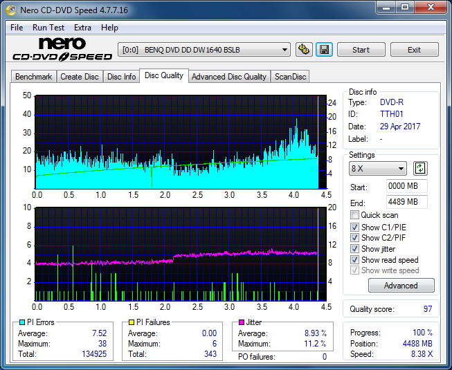

Stary 03.05.2017, 06:11   #37
jadburner
Avatar użytkownika jadburner
Data rejestracji: 07.03.2017
Lokalizacja: Middle Earth
Posty: 9,775

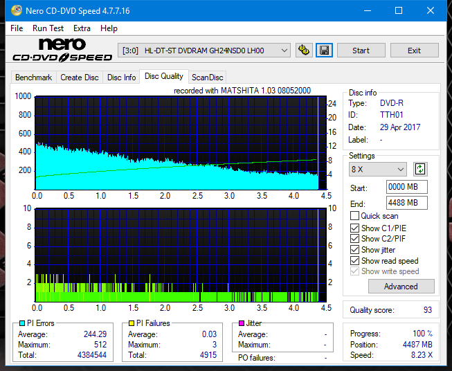

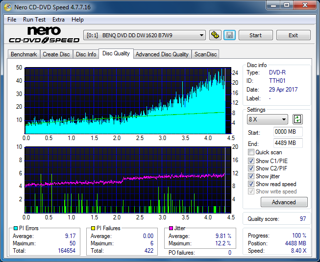

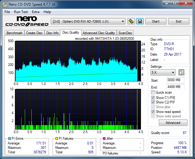

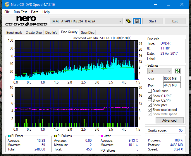

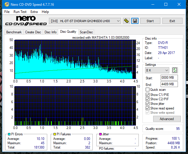

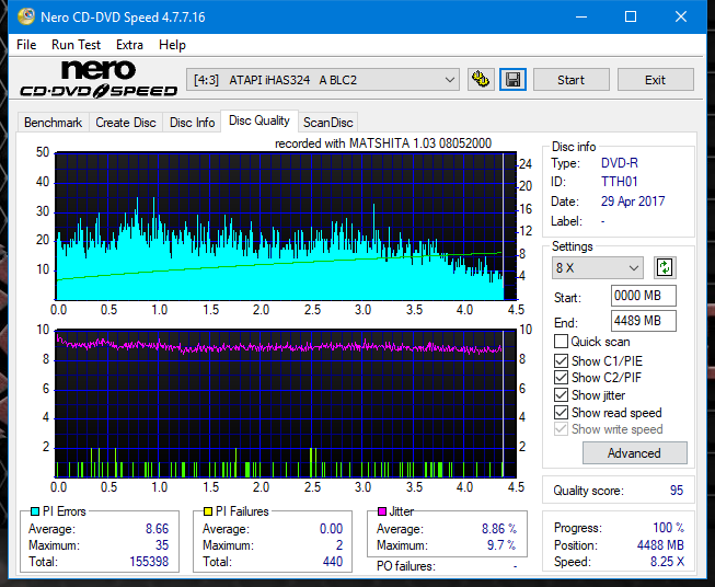

Blank shiny
TTH01 (Made in UAE)
SW-5583 (1.03)
@ 8x

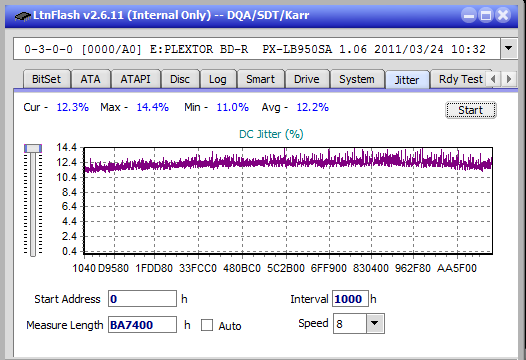

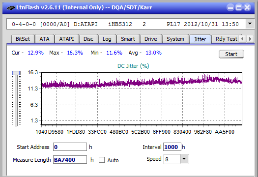

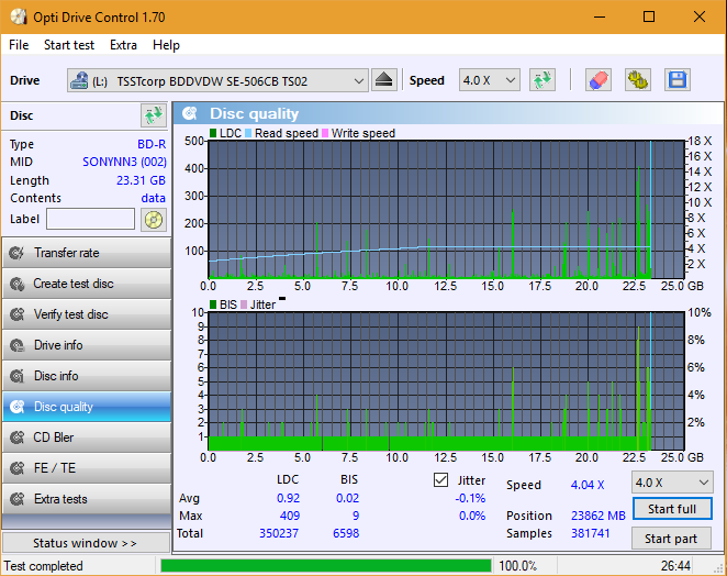

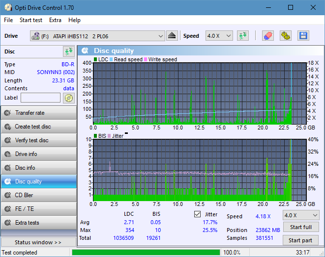

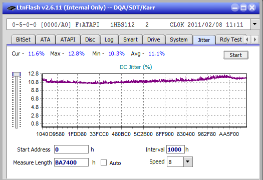

Sony 6x BD-R
White inkjet hub printable
SONY-NN3 (Made in Taiwan)
SW-5583 (1.03)
OPC on
@ 2x

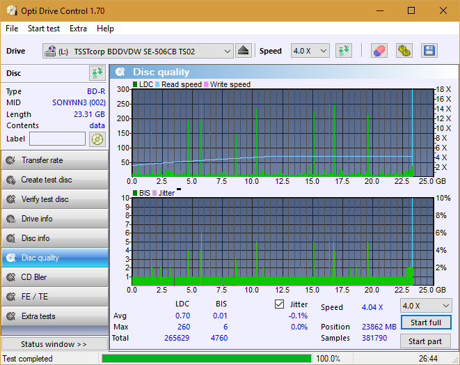

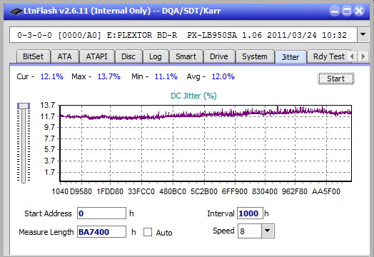

Sony 6x BD-R
SW-5583 (1.03)
OPC on
@ 4x

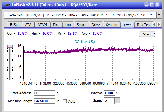

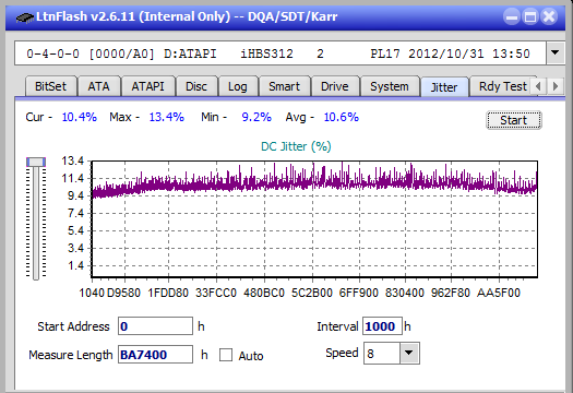

Sony 6x BD-R
SW-5583 (1.03)
OPC off
@ 2x

Sony 6x BD-R
SW-5583 (1.03)
OPC off
@ 4x

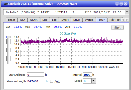

Stary 12.11.2017, 04:51   #43
jadburner
Posty: 9,775
Philips 4x BD-R
Branded
CMCMAG-BA3 (Made in Taiwan)
SW-5583 (1049)
OPC on
@ 2x

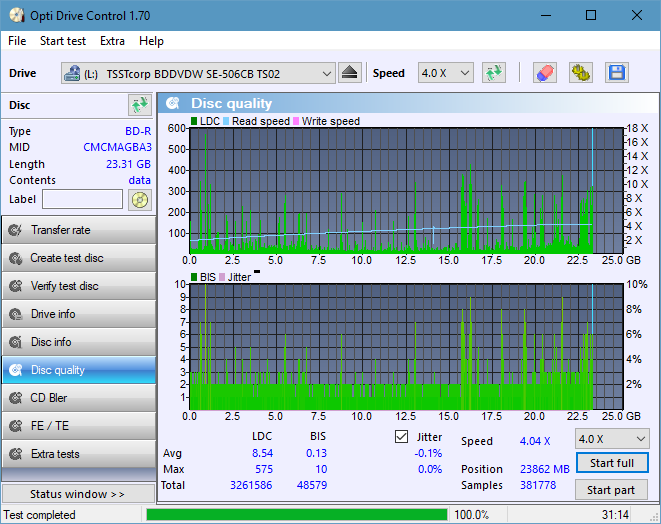

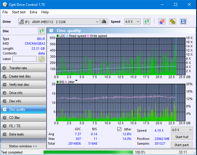

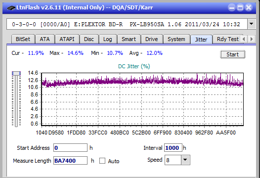

Stary 12.11.2017, 04:56   #44
jadburner
Posty: 9,775

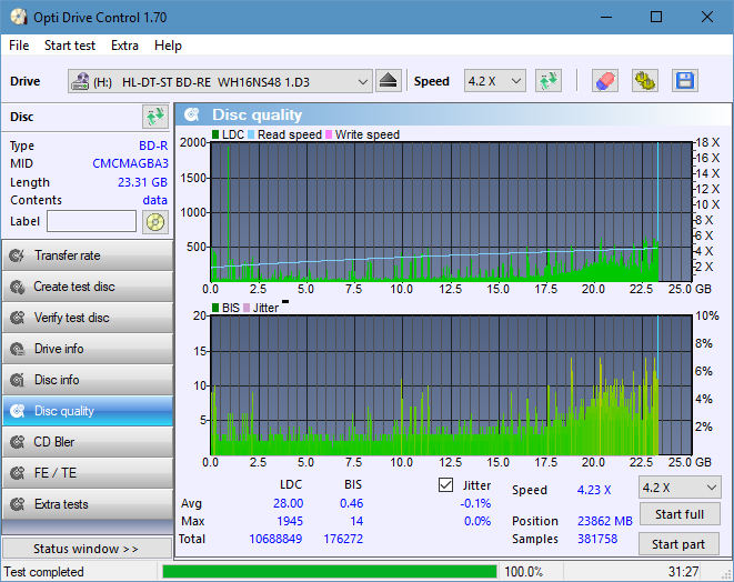

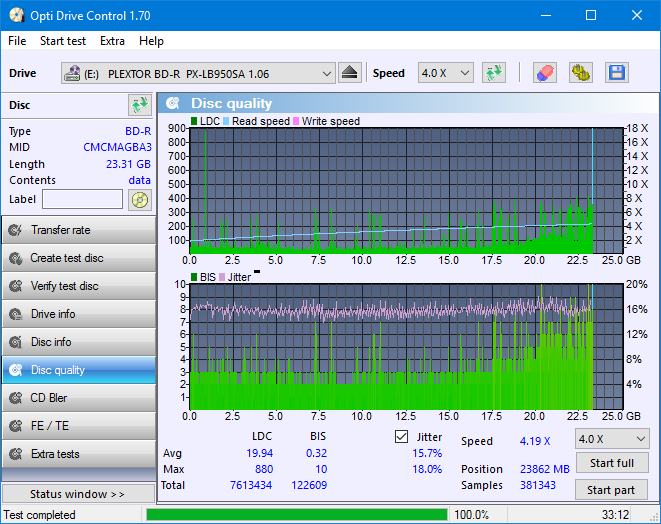

Philips 4x BD-R
Branded
SW-5583 (1049)
OPC on
@ 4x

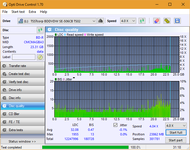

Stary 12.11.2017, 04:59   #45
jadburner
Posty: 9,775
Philips 4x BD-R
Branded
SW-5583 (1049)
OPC off
@ 2x
