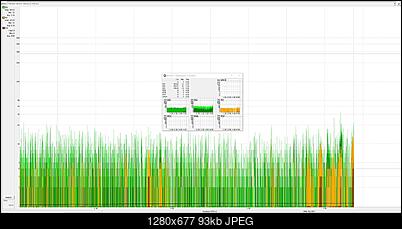

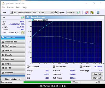

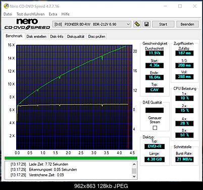

DVD & BluRay Data Read Test
Pioneer BDR-212V - Vinpower / Pioneer-2020-12-13-13_17_34-.jpg   Pioneer BDR-212V - Vinpower / Pioneer-2020-12-13-13_41_36-.jpg
