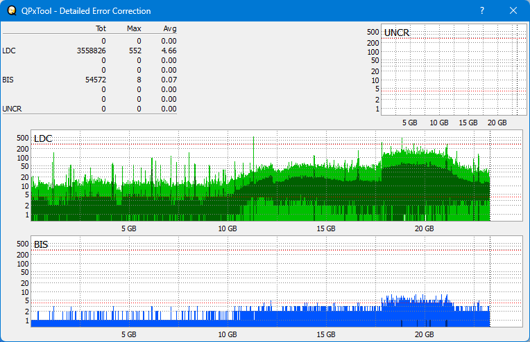

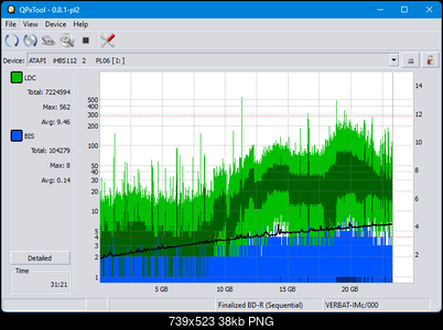

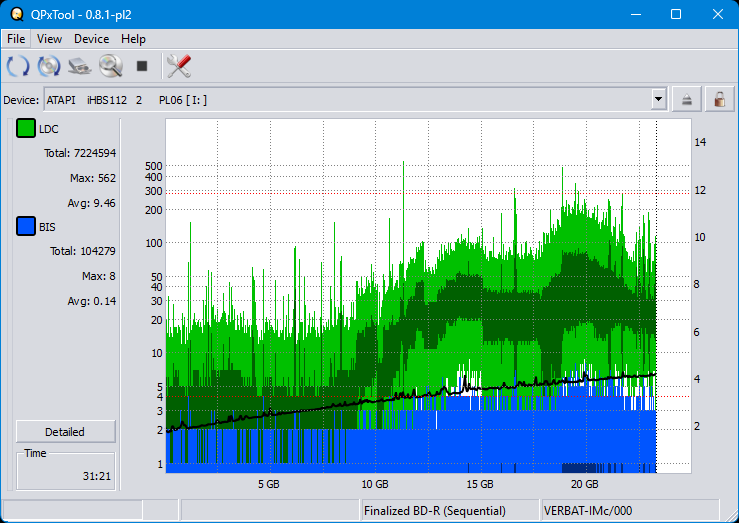

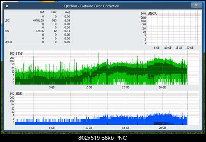

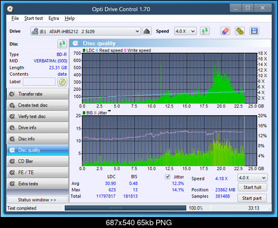

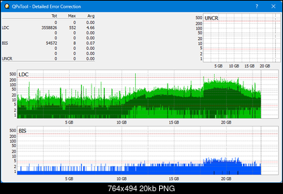

Verbatim 4x BD-R
Branded
VERBATIMc (Made in Taiwan)
BDR-212V --> BDR-S12XLT (1.03)
OPC = No
@ 10x
Pioneer BDR-S12J-BK / BDR-S12J-X  / BDR-212 Ultra HD Blu-ray-createdisc_10x_opcoff.png
Pioneer BDR-S12J-BK / BDR-S12J-X  / BDR-212 Ultra HD Blu-ray-trt_10x_opcoff.png
Pioneer BDR-S12J-BK / BDR-S12J-X  / BDR-212 Ultra HD Blu-ray-dq_odc170_10x_opcoff_ihbs112-gen1.png
Pioneer BDR-S12J-BK / BDR-S12J-X  / BDR-212 Ultra HD Blu-ray-dq_qpxtool_10x_opcoff_ihbs112-gen1.png
Pioneer BDR-S12J-BK / BDR-S12J-X  / BDR-212 Ultra HD Blu-ray-dq_qpxtool-details_10x_opcoff_ihbs112-gen1.png
Pioneer BDR-S12J-BK / BDR-S12J-X  / BDR-212 Ultra HD Blu-ray-dq_odc170_10x_opcoff_ihbs112-gen2.png
Pioneer BDR-S12J-BK / BDR-S12J-X  / BDR-212 Ultra HD Blu-ray-dq_qpxtool_10x_opcoff_ihbs112-gen2.png
Pioneer BDR-S12J-BK / BDR-S12J-X  / BDR-212 Ultra HD Blu-ray-dq_qpxtool-details_10x_opcoff_ihbs112-gen2.png
Pioneer BDR-S12J-BK / BDR-S12J-X  / BDR-212 Ultra HD Blu-ray-dq_odc170_10x_opcoff_ihbs212-gen1.png
Pioneer BDR-S12J-BK / BDR-S12J-X  / BDR-212 Ultra HD Blu-ray-dq_qpxtool_10x_opcoff_ihbs212-gen1.png
Pioneer BDR-S12J-BK / BDR-S12J-X  / BDR-212 Ultra HD Blu-ray-dq_qpxtool-details_10x_opcoff_ihbs212-gen1.png
Pioneer BDR-S12J-BK / BDR-S12J-X  / BDR-212 Ultra HD Blu-ray-dq_odc170_10x_opcoff_wh16ns48dup.png
Pioneer BDR-S12J-BK / BDR-S12J-X  / BDR-212 Ultra HD Blu-ray-dq_qpxtool_10x_opcoff_wh16ns48dup.png
Pioneer BDR-S12J-BK / BDR-S12J-X  / BDR-212 Ultra HD Blu-ray-dq_qpxtool-details_10x_opcoff_wh16ns48dup.png
Pioneer BDR-S12J-BK / BDR-S12J-X  / BDR-212 Ultra HD Blu-ray-dq_odc170_10x_opcoff_wh16ns58dup.png
Pioneer BDR-S12J-BK / BDR-S12J-X  / BDR-212 Ultra HD Blu-ray-dq_qpxtool_10x_opcoff_wh16ns58dup.png
Pioneer BDR-S12J-BK / BDR-S12J-X  / BDR-212 Ultra HD Blu-ray-dq_qpxtool-details_10x_opcoff_wh16ns58dup.png
Pioneer BDR-S12J-BK / BDR-S12J-X  / BDR-212 Ultra HD Blu-ray-jitter_10x_opcoff_ihbs112-gen1.png
Pioneer BDR-S12J-BK / BDR-S12J-X  / BDR-212 Ultra HD Blu-ray-jitter_10x_opcoff_ihbs112-gen2.png
