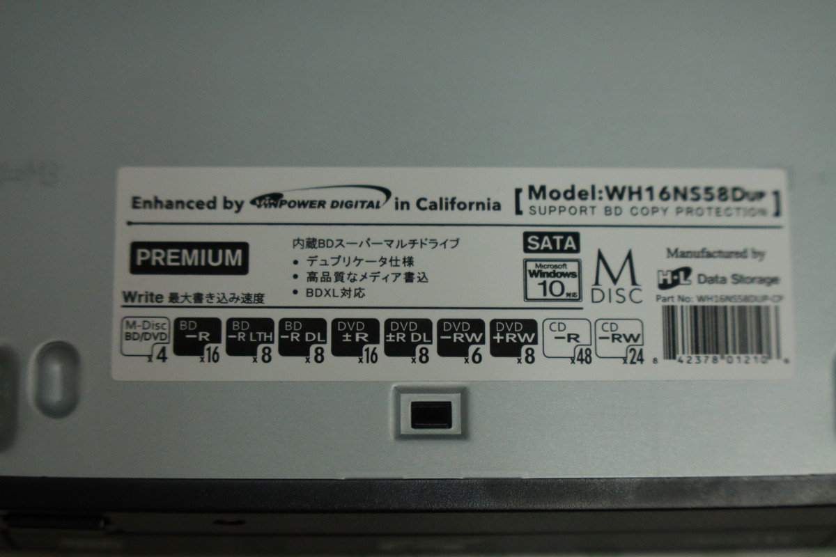

Hello,
I have solved this problem for a long time with the technical support of Vinpowerdigital.com, where I was told that the "58D and version robot" models can measure the quality (disc quality check), so I ordered the model: "robot" for more money and I received an identical model from: "labelprinter.pl", which also cannot measure the quality of burned media.
I returned both models back to: "Labelprinter.pl" and I am currently waiting for a refund.
I do not know if it was a mistake on the side of the labelprinter.pl or directly to the vigpowerdigital.com, but on the following models:
"DUP versions" cannot measure the quality of burned media in any programs.
I tested the firmware upgrade to version 1. V9 and downgrade on version 1. V5.
Interestingly, the second unit purchased had the same identification labels, but different firmware:
Drive no.1: "WH16NS58 1V8" Firmware.
Drive no. 2: (Reportedly Robot version): "WH16NS58 TSTK Firmware.
Pics (Comparison of drives):

Question no. 1:
It's not by the SATA controller. I tried to connect the drive also via an external USB box: "OWC Mercury Pro":
https://www.owc.com/solutions/mercury-pro-optical
I was also thinking about buying from Amazon.com
People in the discussion for this product write that this drive supports quality measurement.
Link Amazon product: Digital LG HLDS WH16NS58DUP
If you would ask Vinpower Digital directly via Amazon.com about this function with a link on this forum and this problem, maybe you will be succeed. Then I would definitely buy this drive from Amazon.com as well.
Question no. 2:
Firmware 1.V9 I received from technical support: VINPOWER Digital (Germany's Office).
Question no. 3:
I did not receive a list of changes, but if you request it, they will surely give it to you.
I have this firmware available.

All solved!
I ordered before Christmas the drive on Amazon.com and that can measure the quality of burned media. !!!
I asked the seller on Amazon.com several times and was told that the drive has this feature.
Note: Otherwise, as far as the label and inscription: "Support Quality Scan" are concerned, this is a designation only for the European market. The American label on the drive does not have this marking, but the drive have this function (quality measurement).
You will get 5x BD-R disc (Plexdisc 25 GB) and 1x CD-R with PlexTools software with the drive.
Note: BD-R and CD-R (without plastic cover see, photos below), the covers is mine.
Link to purchase: LG HLDS WH16NS58DUP 16X Blu-ray - Amazon.com
Pictures:
Panasonic BD-RE 2x (Quality Scan).
I wish everyone who is interested in buying this drive a pleasant and trouble-free purchase.
