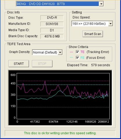

Stary 22.01.2005, 01:06   #1189
Sony DVD-R x8 FullScan x16 1620B7T9

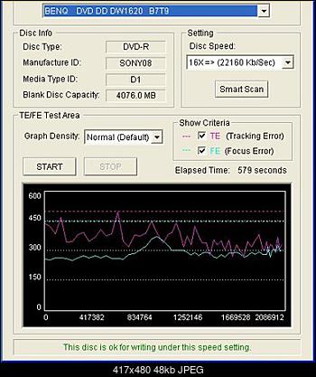

Stary 22.01.2005, 01:08   #1190
Sony DVD-R x8 burn x16 1620B7T9
File Type: png Kopia Sonyx8-RB7T9(x16)+VS0B.PNG (45.5 KB, 221 oglądane)
