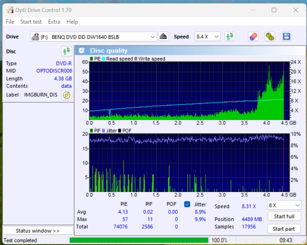

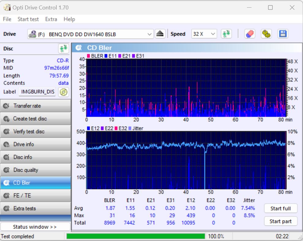

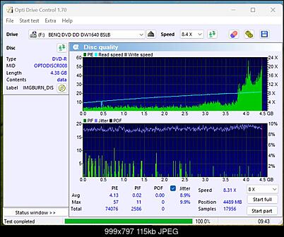

BenQ DW 1640 Refurbished
BenQ DW1640 BSLB Refurbished
A Philips PBDV1628B was used as a spare part donor.
The laser unit and the data cable were defective. These components were removed from the Philips and installed into the BenQ. It was a bit tricky,
the BenQ and the Philips had to be completely dismantled.
The old housing was reused.
Enclosed: HP CD-R Silver Blue burned at 16x
Samsung Pleomax 8x DVD-R burned @ 8x
It is always worth repairing old devices
Many thanks to czary2mary.
I have used his Topic with detailed Pictures in this Forum to repair my old BenQ.
You can find it here: BenQ DW 1640 Refurbished \wymiana OPU Philipsa - Forum CDRinfo.pl
Greetings Kirby
