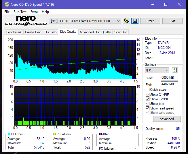

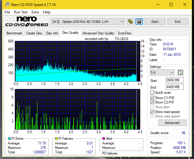

That's interesting news! Are the results reasonable/comparable with other drives?
My copy has issues to read discs again, but burning quality seems perfect still...
Maxell DVD+R 16x, RITEK F16
TSST TS-LB23D SC02 @8x
Załącznik 146157
Załącznik 146158
