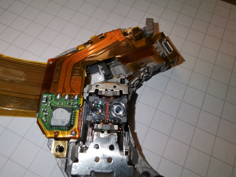

Hi jadburner,
I missed that I missed to answer you

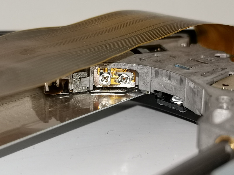

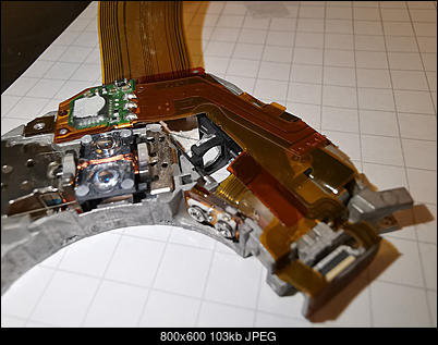

Yeah, that was my original wish, but I have just retired my copy. It turned out, that the unit got bigger and bigger issues to read CDs and DVDs, however CD/DVD burning did work flawlessly. I suspected some driver issues after playing with AnyDVD and DVDFab, because usually cold boot with disc in was successful.
Now I definitely excluded external factors, tried the drive in external case and with another PC - BD laser reads BD-ROM discs, but with BD-R and BD-RE shows media as empty (strangely each time is able the MID of inserted disc independently of type). Cleaning with compressed air and some cotton pads did not bring any BD improvement, CD/DVD readability was restored to normal.
I even tried flashing with older SC01 and re-flashing with original SC01 firmware - no luck there.
I wonder if the diode itself was so crappy or maybe the environment killed it? I noticed some fine dust inside of the unit, there is no sealing at all that could stop it.
I just installed Optiarc BD-5750L instead, (BC-5500S kept crashing for some reason), but if the dust is the killer I'd rather save the burner in a sealed bag...

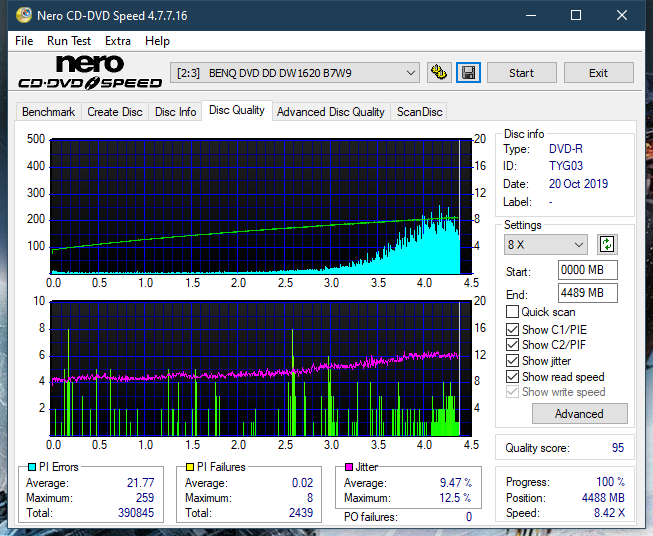

Legend with PRO 16x DVD-R
White inkjet hub printable
TYG03 (Made in Taiwan)
TS-LB23L (0600)
@ 3.3x

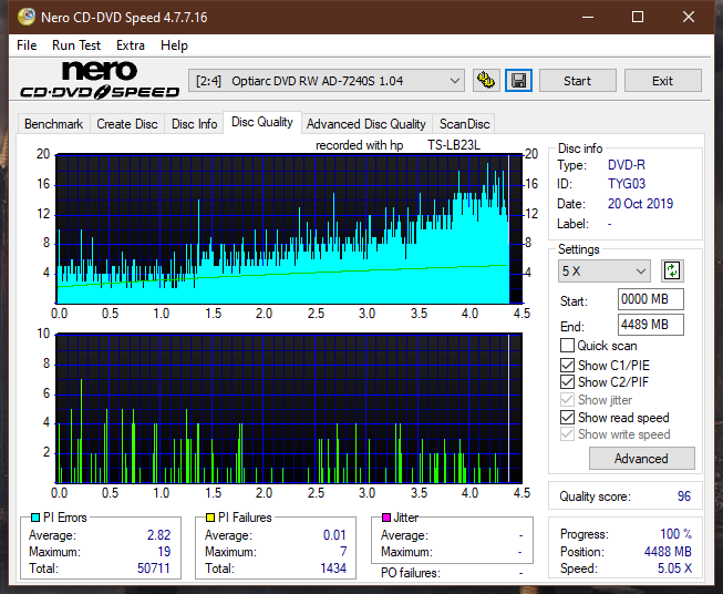

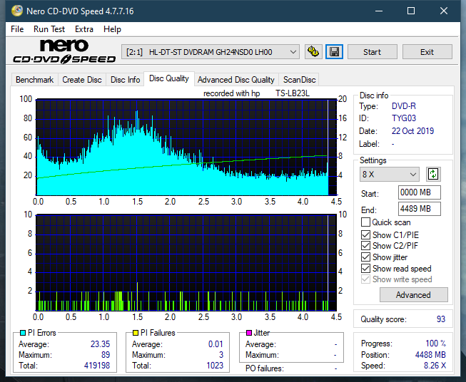

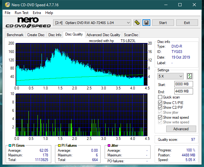

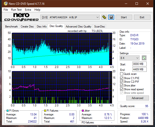

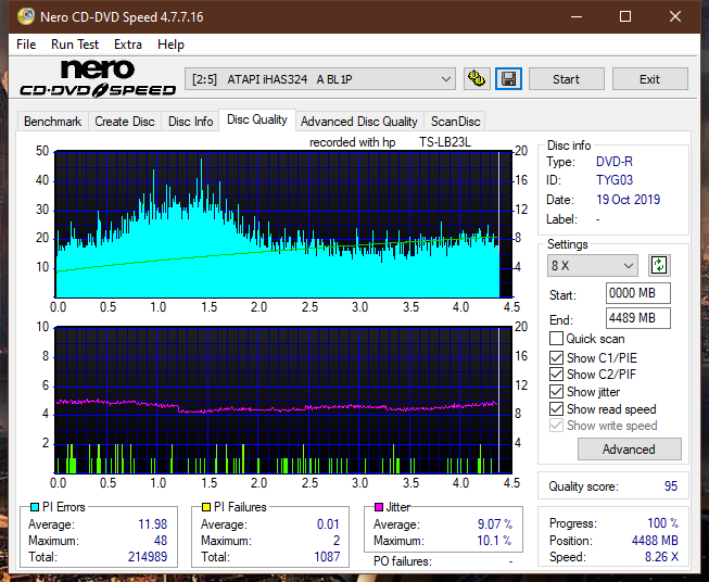

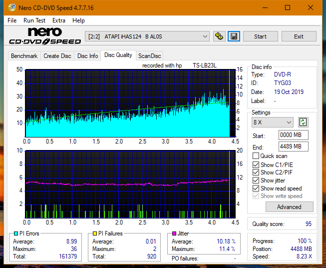

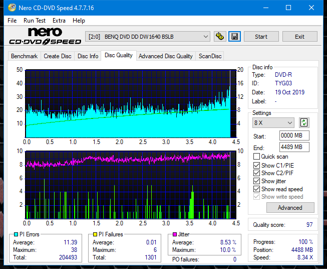

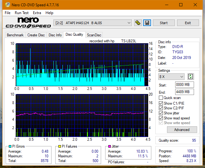

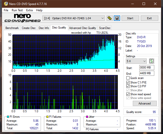

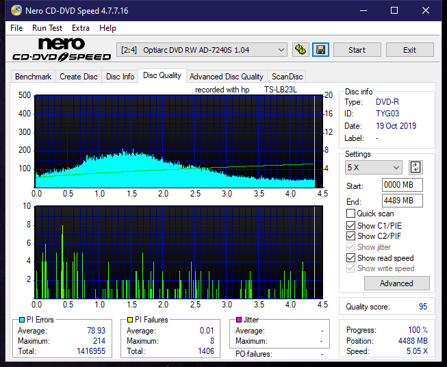

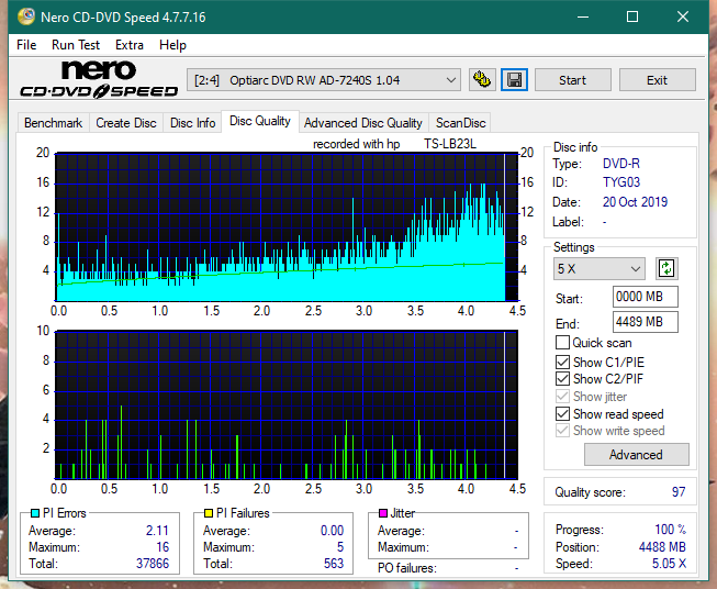

I've only done very limited scanning with the TS-LB23L. Results for LDC and BIS were higher than most other drives, but not all. It's probably best used as a secondary scanner.
czary2mary brought QPxTool to my attention, so he deserves the credit.
