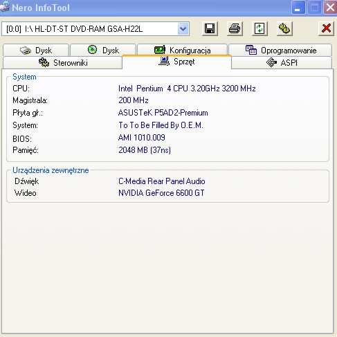

wklej screen'a z nero info tool

Oto screeny:
