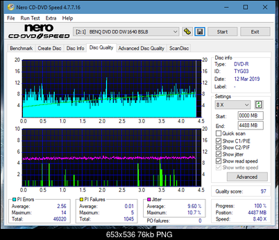

Stary 10.04.2019, 05:00   #31
jadburner
Avatar użytkownika jadburner
Data rejestracji: 07.03.2017

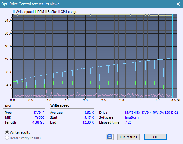

Lokalizacja: Middle Earth
Posty: 10,057
Legend with PRO 16x DVD-R
White inkjet hub printable
TYG03 (Made in Taiwan)
SW820 (D.02)
@ 16x
Panasonic SW810/SW820/SW830/SW840-createdisc_16x.png
Panasonic SW810/SW820/SW830/SW840-trt_16x.png
Panasonic SW810/SW820/SW830/SW840-dq_16x_dw1620.png
Panasonic SW810/SW820/SW830/SW840-dq_16x_dw1640.png
Panasonic SW810/SW820/SW830/SW840-dq_16x_ad-7240s.png
Panasonic SW810/SW820/SW830/SW840-dq_16x_ihas324-.png
Panasonic SW810/SW820/SW830/SW840-dq_16x_ihas124-b.png
Panasonic SW810/SW820/SW830/SW840-dq_16x_gh24nsd0.png
Panasonic SW810/SW820/SW830/SW840-ta-test-inner-zone-layer-0-_16x_px-716a.png
Panasonic SW810/SW820/SW830/SW840-ta-test-middle-zone-layer-0-_16x_px-716a.png
Panasonic SW810/SW820/SW830/SW840-ta-test-outer-zone-layer-0-_16x_px-716a.png

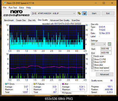

Taiyo Yuden 16x DVD-R
Silver shiny
TYG03 (Made in Japan)
SW820 (D.02)
@ 6x
Panasonic SW810/SW820/SW830/SW840-createdisc_6x.png
Panasonic SW810/SW820/SW830/SW840-trt_6x.png
Panasonic SW810/SW820/SW830/SW840-dq_6x_dw1620.png
Panasonic SW810/SW820/SW830/SW840-dq_6x_dw1640.png
Panasonic SW810/SW820/SW830/SW840-dq_6x_ad-7240s.png
Panasonic SW810/SW820/SW830/SW840-dq_6x_ihas324-.png
Panasonic SW810/SW820/SW830/SW840-dq_6x_ihas124-b.png
Panasonic SW810/SW820/SW830/SW840-dq_6x_gh24nsd0.png
Panasonic SW810/SW820/SW830/SW840-ta-test-inner-zone-layer-0-_6x_px-716a.png
Panasonic SW810/SW820/SW830/SW840-ta-test-middle-zone-layer-0-_6x_px-716a.png
Panasonic SW810/SW820/SW830/SW840-ta-test-outer-zone-layer-0-_6x_px-716a.png

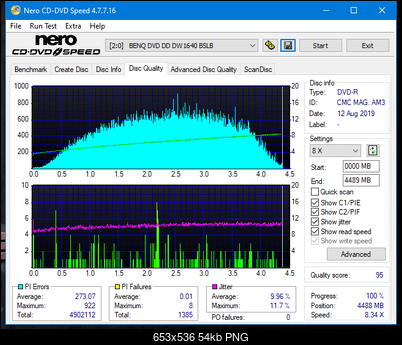

Stary 26.08.2019, 06:38   #37
jadburner
Posty: 10,057

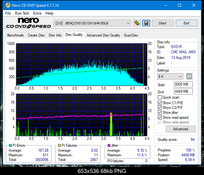

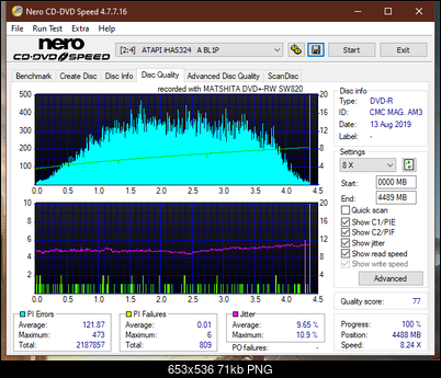

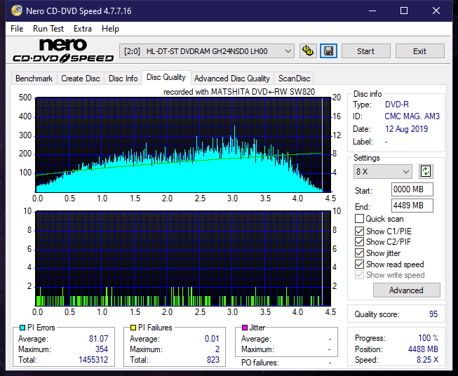

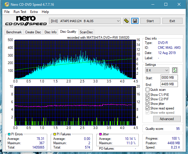

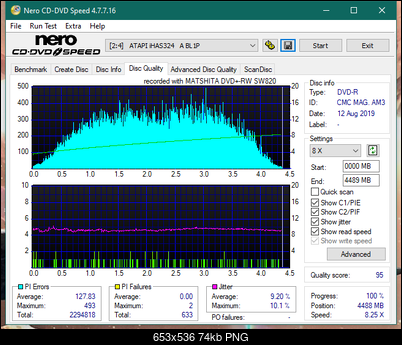

LG 16x DVD-R
Branded
CMC MAG. AM3 (Made in Taiwan)
SW820 (D.02)
@ 6x

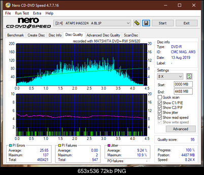

Stary 26.08.2019, 06:41   #38
jadburner
Posty: 10,057
LG 16x DVD-R
Branded
SW820 (D.02)
@ 8x
Panasonic SW810/SW820/SW830/SW840-createdisc_8x.png
Panasonic SW810/SW820/SW830/SW840-trt_8x.png
Panasonic SW810/SW820/SW830/SW840-dq_8x_dw1620.png
Panasonic SW810/SW820/SW830/SW840-dq_8x_dw1640.png
Panasonic SW810/SW820/SW830/SW840-dq_8x_ad-7240s.png
Panasonic SW810/SW820/SW830/SW840-dq_8x_ihas324-.png
Panasonic SW810/SW820/SW830/SW840-dq_8x_ihas124-b.png
Panasonic SW810/SW820/SW830/SW840-dq_8x_gh24nsd0.png
Panasonic SW810/SW820/SW830/SW840-ta-test-inner-zone-layer-0-_8x_px-716a.png
Panasonic SW810/SW820/SW830/SW840-ta-test-middle-zone-layer-0-_8x_px-716a.png
Panasonic SW810/SW820/SW830/SW840-ta-test-outer-zone-layer-0-_8x_px-716a.png

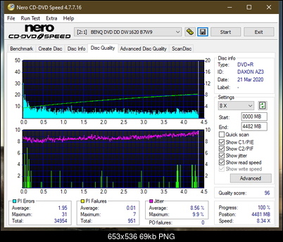

Stary 28.03.2020, 23:05   #41
jadburner
Posty: 10,057

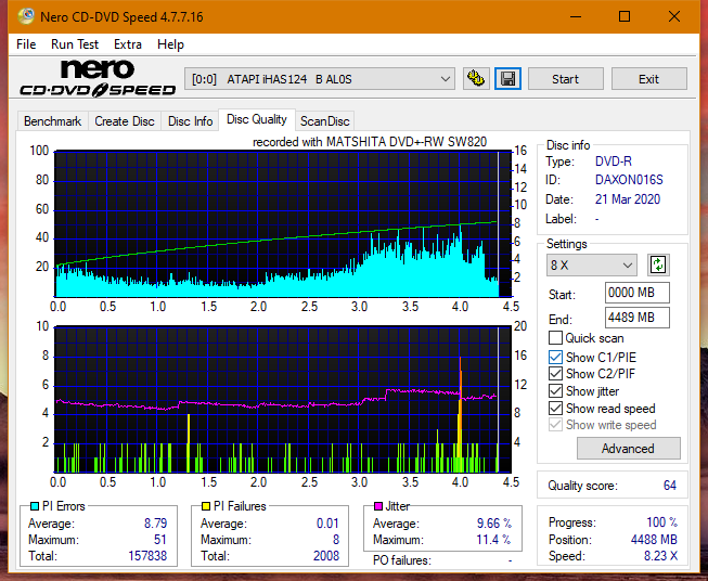

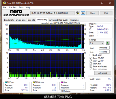

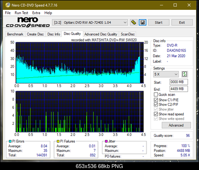

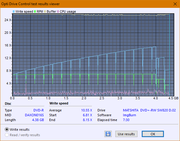

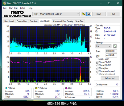

BenQ 16x DVD-R
Branded
DAXON016S (Made in Malaysia)
SW820 (D.02)
@ 6x

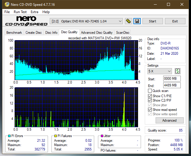

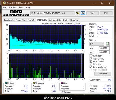

Stary 28.03.2020, 23:08   #42
jadburner
Posty: 10,057
BenQ 16x DVD-R
Branded
SW820 (D.02)
@ 8x
