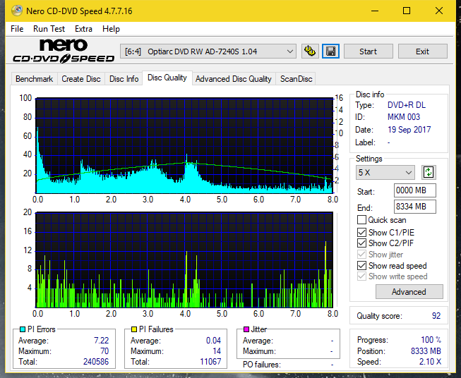

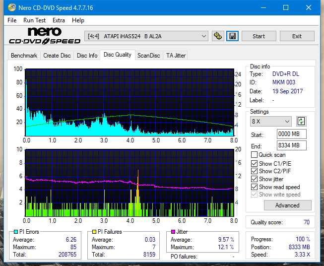

FalconMedia Vision 8x DVD+R DL
White inkjet hub printable
MKM 003 (Made in UAE)
DVR-S21D+ (1.CZ)
SB on, FHT/OS/OHT off
@ 8x

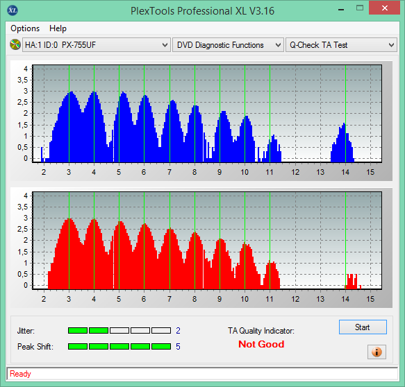

Have you got the LiteOn DH-16AFSH Premm?
On the LiteOn side they write with jitter support? Interesting whether in their program or in others. I have never seen anyone hold this program for this model?

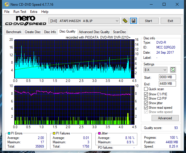

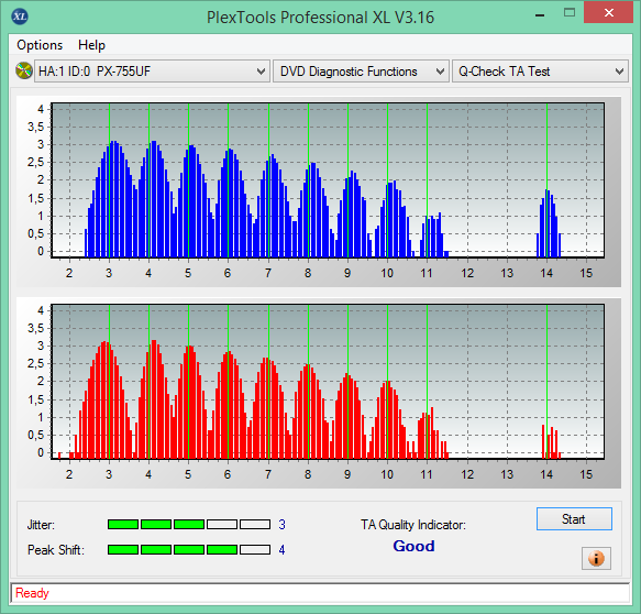

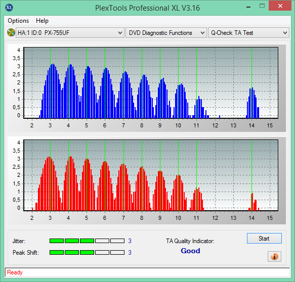

Verbatim DataLifePlus 8x DVD-R
Silver shiny
MCC 02RG20 (Made in Taiwan)
DVR-S21D+ (1.CZ)
@ 6x

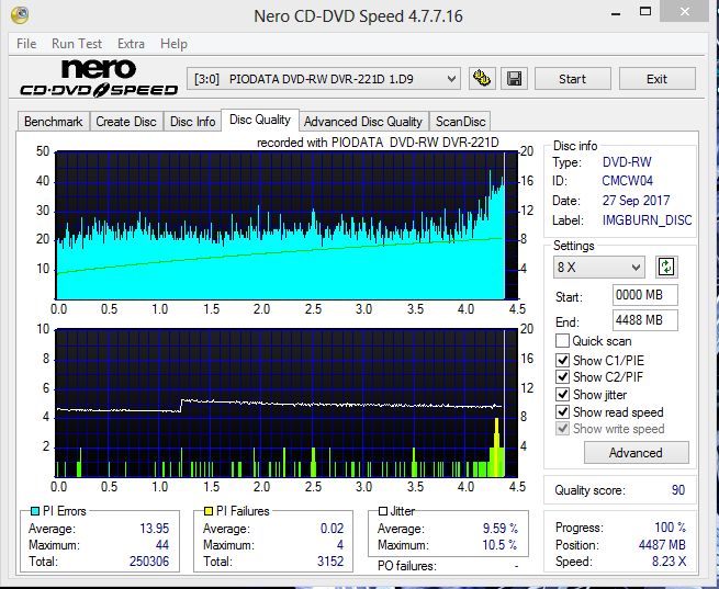

Stary 09.10.2017, 12:26   #44
Posty: 22,828
Sony DVD+R MID:SONYD21
PioData DVR-S21DBK fw.1.D9
ImgBurn 2.5.8.0. x8

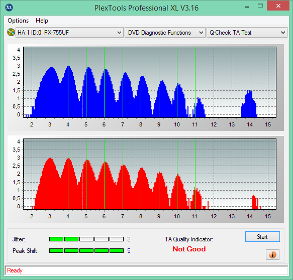

Stary 10.10.2017, 07:24   #45
Posty: 22,828
Verbatim CD-RW 700MB UltraSpeed 32x ATIP:97m34s25f
ImgBurn 2.5.8.0 x16
