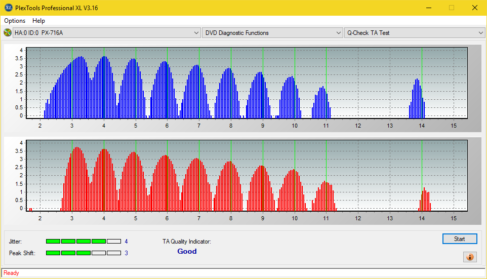

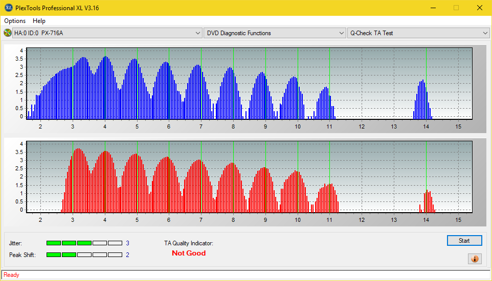

jadburner 21.05.2018 07:31
Ilość załączników: 11
CMC Pro (Powered by TY) 8x DVD+R
Silver shiny
YUDEN T02 (Made in Taiwan)
SH-224GB (SB00)
@ 6x
(The drive created a burn ring at this speed)

lee99 21.05.2018 09:35
Wina napędu czy te płyty takie śmieci?
czary2mary 21.05.2018 10:28
Napisany przez jadburner (Post 1405160)
Silver shiny
SH-224GB (SB00)
@ 8x
Strange that the record x4 very good?
Do you have the Japanese YUDEN000 T02? How do you have to try writing them x8 on them?
I have the impression that it is a fault, however, TSST drive and too strong laser beam.
jadburner 21.05.2018 17:12
Napisany przez lee99 (Post 1405162)
Nie jestem pewny. Nagrywaj***261; bardzo dobrze na prawie wszystkich moich pozosta***322;ych nagrywarkach.
jadburner 21.05.2018 17:17
Napisany przez czary2mary (Post 1405164)
Yes, I will try JVC YUDEN T02s on this drive and post the results. The 6x burn was the fault of the drive, since it created a definite burn ring.
czary2mary 21.05.2018 17:33
Napisany przez jadburner (Post 1405185)
Perhaps these drives do not do well with many terrible constructions of DVD media?
It also seems to me that at x6 the OPC has corrected the power of the laser beam and the DVD media is better saved.

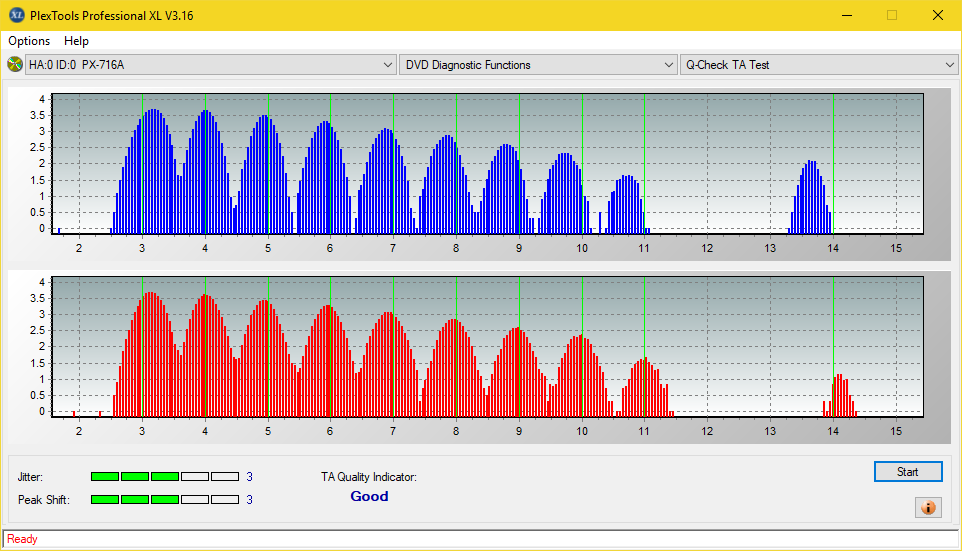

jadburner 26.05.2018 06:32
Taiyo Yuden 8x DVD+R
Silver shiny
YUDEN T02 (Made in Japan)
SH-224GB (SB00)
@ 4x
Much better results than the CMC Pros.

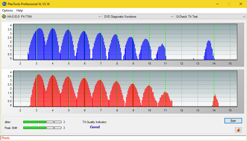

jadburner 26.05.2018 06:35
Silver shiny
SH-224GB (SB00)
@ 6x

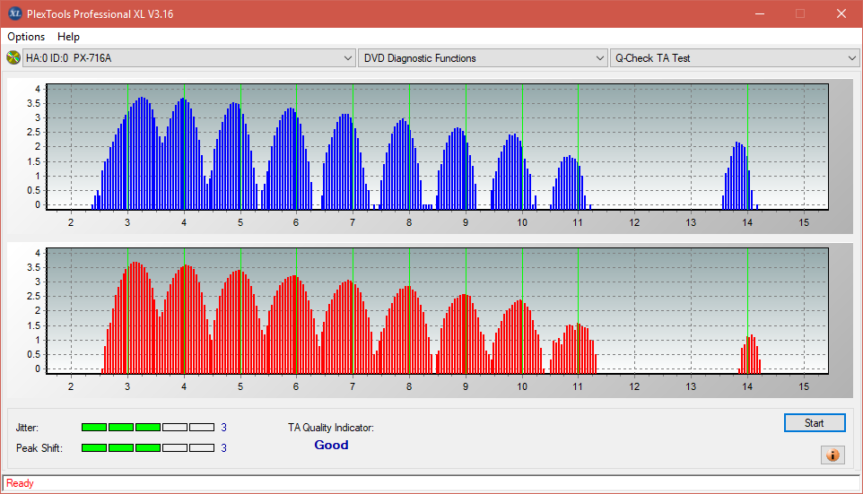

jadburner 26.05.2018 06:38
Silver shiny
SH-224GB (SB00)
@ 8x

czary2mary 26.05.2018 06:54
Napisany przez jadburner (Post 1405384)
Silver shiny
SH-224GB (SB00)
@ 4x
Znacznie lepsze wyniki niż CMC Pro.
Thanks for testing "Japanese". Much better results. But also you can see that when writing with speeds x6 and x8, the drive has small problems when changing the write speed.
Japanese YUDEN000 T02 - we have to produce the best DVD + R media.
Taiwanese YUDEN000 T02 - we need to produce DVD + R media as cheap as possible.
