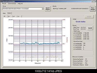

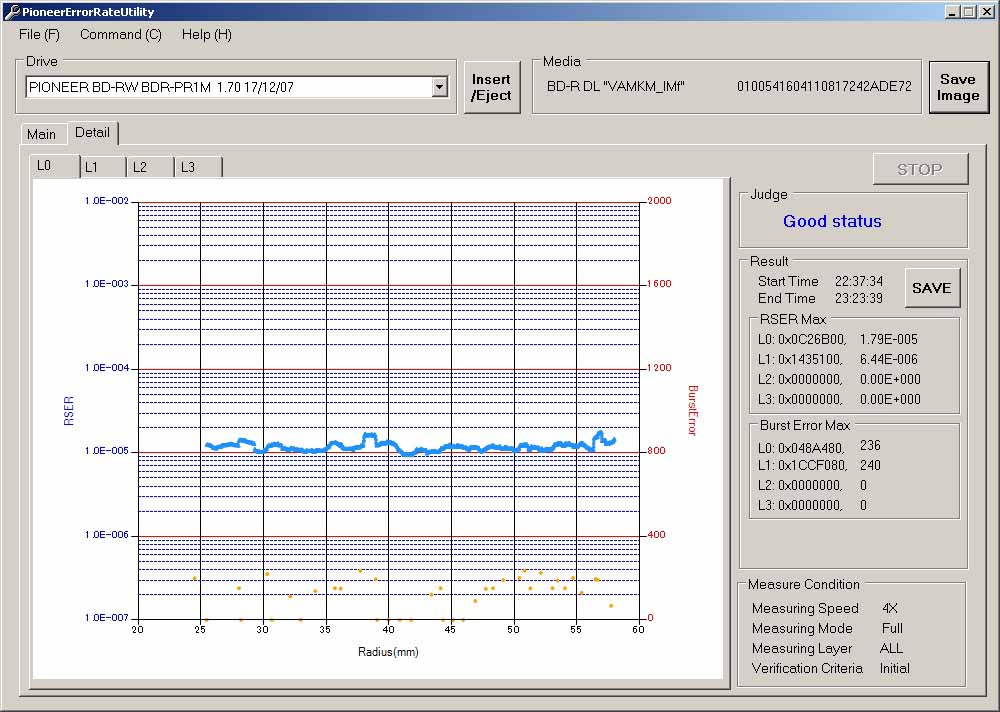

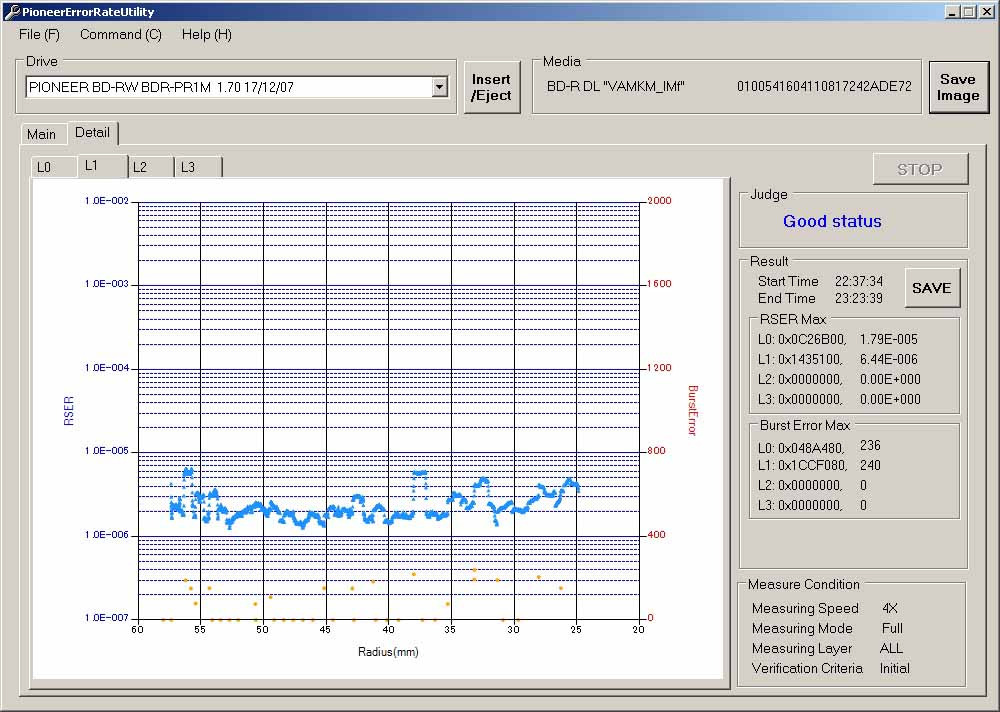

Mitsubishi Kagaku Media (MKM) 50GB VAMKM-IMf
Mitsubishi Kagaku Media (MKM) 50GB Archive Discs (Jiima certified)
MID: VAMKM-IMf
Product code: MKM ASBS25RDJP
burned @2x (without defect management) PR1MC, scan @4x
Mitsubishi Kagaku Media (MKM) 50GB VAMKM-IMf-vamkm-imf_pr1mc_2x_nodm_pr1mc_l0.jpg   Mitsubishi Kagaku Media (MKM) 50GB VAMKM-IMf-vamkm-imf_pr1mc_2x_nodm_pr1mc_l1.jpg   Mitsubishi Kagaku Media (MKM) 50GB VAMKM-IMf-vamkm-imf_pr1mc_2x_nodm_wh16ns48.jpg

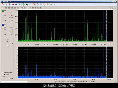

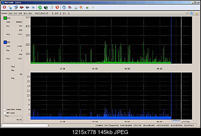

I found out, that the Sony 50GB discs with MID SONY-ND6 are also excellent discs (about the same quality as the Mitsubishi VAMKM-IMf discs). And those I always burnt with my cheap LG WH16NS48! I used that drive for burning and scaning at least 200 discs and it still works. I have taken the SONY-ND6 discs out of SONY ODC 600R cartridges
blackice jest offline   Odpowiedz cytując ten post
Stary 15.02.2026, 12:18   #12
blackice
Data rejestracji: 12.06.2025
Posty: 24
blackice zaczyna zdobywać reputację <1 - 49 pkt>
SONY 50GB from ODC 600R cartdridge
MID: SONY-ND6
burned @4x (with defect management) LG WH16NS48, scan @4x
Mitsubishi Kagaku Media (MKM) 50GB VAMKM-IMf-sony-nd6_wh16ns48_1_4x_withdm_pr1mc2_-b-bd068-test-_l0.jpg   Mitsubishi Kagaku Media (MKM) 50GB VAMKM-IMf-sony-nd6_wh16ns48_1_4x_withdm_pr1mc2_-b-bd068-test-_l1.jpg   Mitsubishi Kagaku Media (MKM) 50GB VAMKM-IMf-sony-nd6_wh16ns48_4x_withdm_wh16ns48_-b-bd068-test-.jpg
