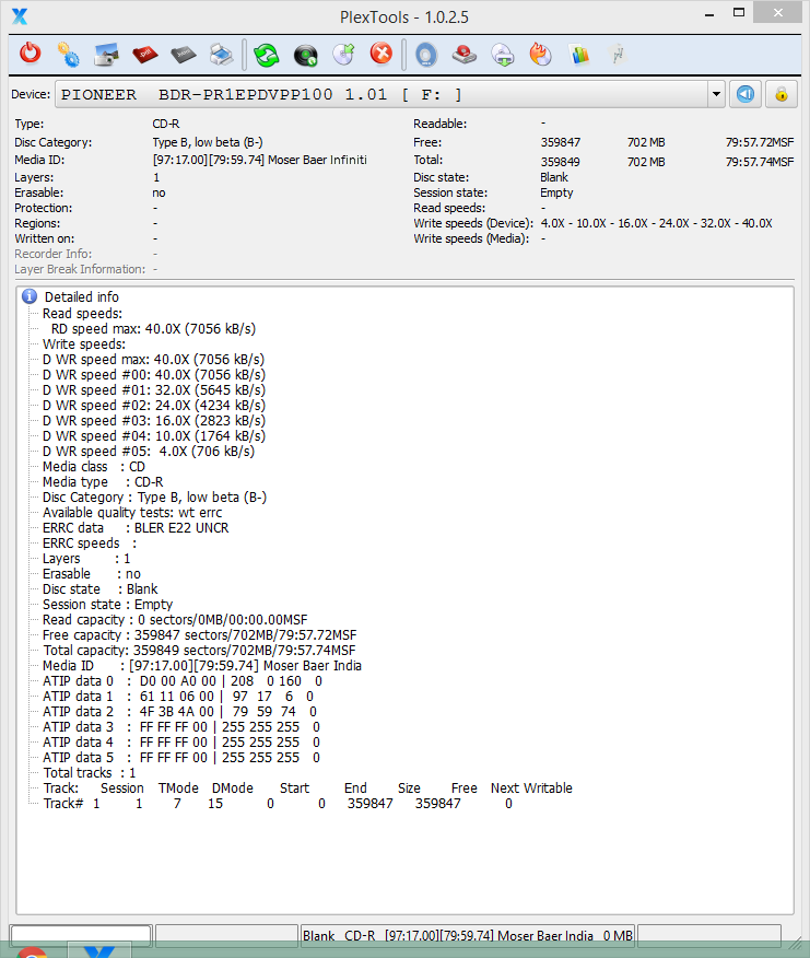

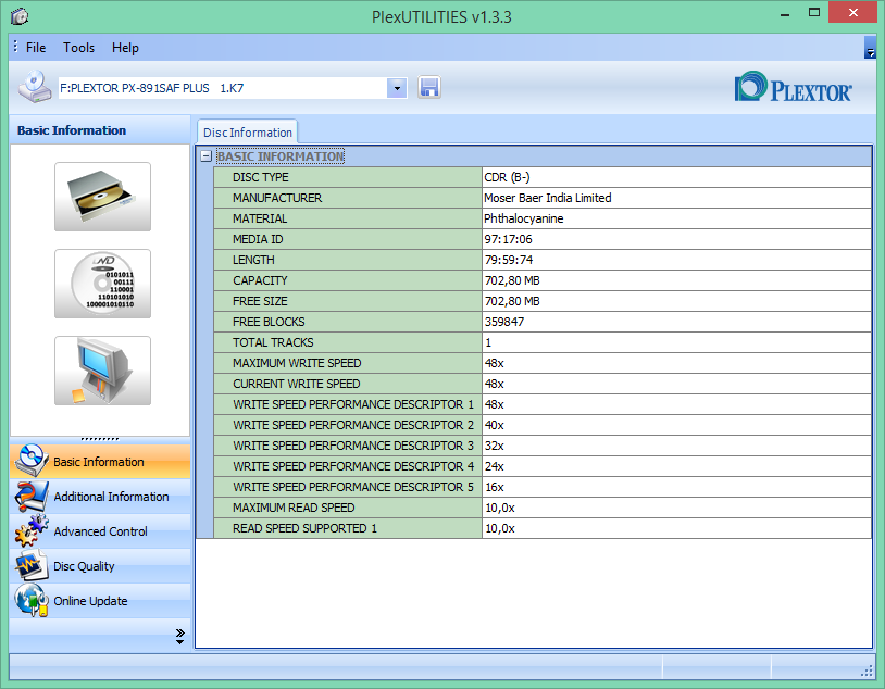

Imation CD-R x52 Lightscribe
Tłocznia MBI India \ ATIP 97m17s06f
