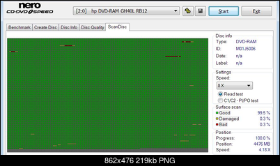

But I also have a Panasonic 2-5x M01J5006 DVD-RAM (Japanese, I assume) lying also here, its quite dirty and dusty, but after washing and drying it, it looks to be in good condition with only a few scratches. The folders on it date back to 2011 (15 years ago), and about 3 GB of space has been used. A surface test in Nero CD-DVD Speed showed 0.3% damaged areas and 0.3% unreadable areas. Hmm, I expected it to be fully readable :-)
But some of the scratches might have caused this, even though there arent many of them.

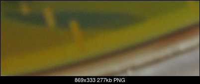

I was looking at it yesterday and noticed that theres also a black spot on this DVD-RAM. Its right at the edge of the disc, so it didnt affect the test because there are 3 GB of data recorded on it. Unfortunately, I dont have a good camera with a macro mode, but a friend of mine used to have a microscope, maybe we could take some better photos with that.
File Type: jpg cut1.jpg (59.1 KB, 3 oglądane)
File Type: png cut2.png (276.6 KB, 3 oglądane)
File Type: png scancut.png (218.6 KB, 3 oglądane)

Yah that is typical de-lamination of layers. Somewhere there is photo of my BDs, and one CD that was i think literally eaten by some microbes with marks of eating on it.

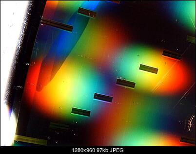

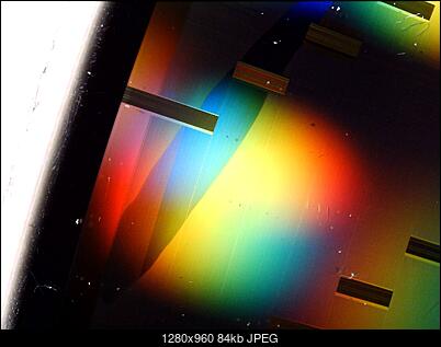

I managed to borrow a school microscope, so here are some photos of a spot on a DVD-RAM. Unfortunately, the microscope didn't have very high magnification.
File Type: jpg 260901151541537.jpg (96.6 KB, 4 oglądane)
File Type: jpg 260901151959718.jpg (83.8 KB, 3 oglądane)
huh22 jest offline   Odpowiedz cytując ten post

Delamination 100%
