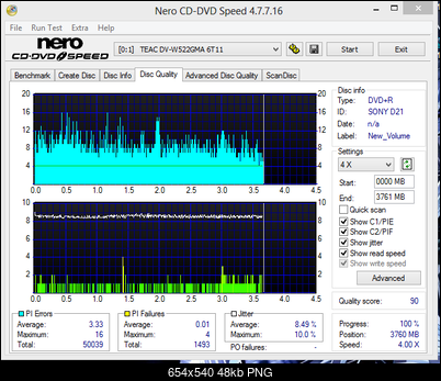

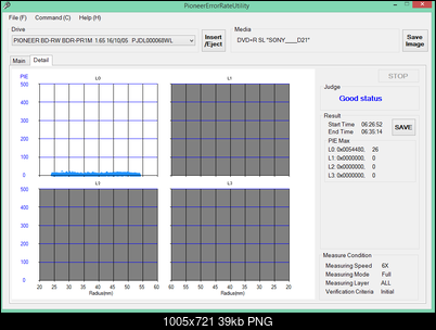

Stary 27.11.2018, 05:13   #9
Posty: 22,768
Sony DVD+R MID:SONYD21
Pioneer BDR-PR1 MC-U 200 Almedio JIZ 6017 fw.1.65
ImgBurn 2.5.8.0. x4
sony, sony dvd+r 16x, sony nośnik dvd+r
