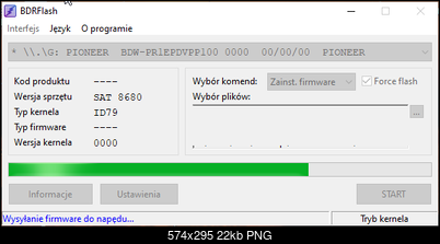

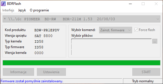

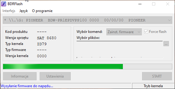

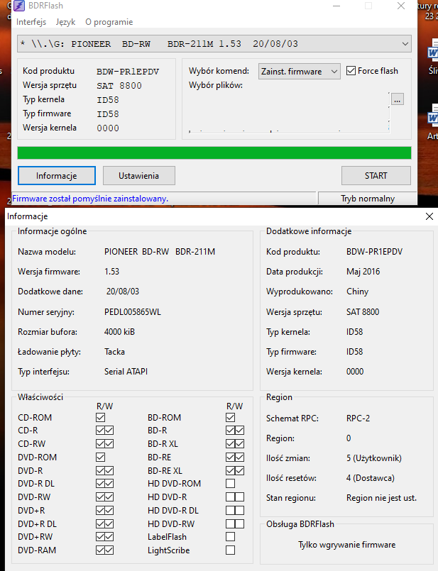

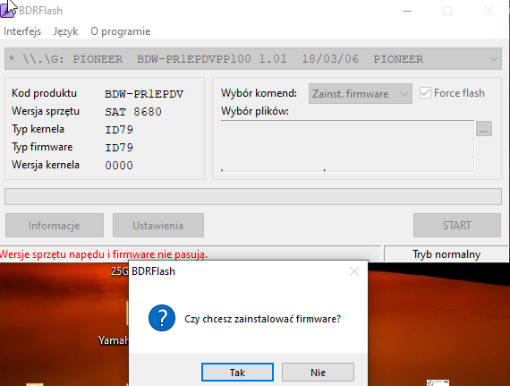

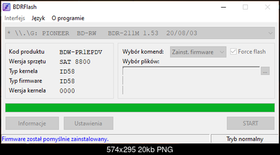

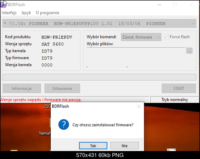

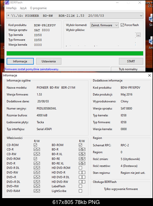

Pioneer BDR-PR1 EPDV PP 100 Hardware 8680 version for Espon devices is identical to Pioneer BDR-209/S09/211/S11 hardware 8600/8800. It is even possible to reprogram the device for Pioneer BDR-209/S09/211/S11 recorders that record/erase RW/RE media and support BD-R\RE XL 100/128GB media.
Załącznik 217799
Załącznik 217800
Załącznik 217801
Załącznik 217802
Please provide firmware, thank you.
