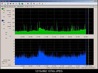

The burn is decent. Not a masterpiece, as I had far better ones with VERBAT-IMk 100GB discs.

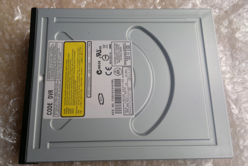

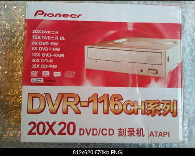

The solution to this problem is very simple and has been known for a long time.
Since at least 2007, Chinese companies have been inserting old, used Pioneer DVD and Blu-ray drives into OEM Chinese QSI cases for the Pioneer DVR-118/218/119/219 and selling them as new. The issue concerned the DVR-106/107/108/109/112/116/117/216/217, and there may have been others. For Blu-ray, there were the BDR-206/207/209/212 and the BD-ROM BDC-207.
The same issue arose with the LiteOn IHAS B, where they were installed in newer IHAS CU/DU/EU/FU enclosures, as well as the BuRay LiteOn iHBS 112/212 and Optriac BD-5300S drives.
I remember when I received a newly purchased iHBS212 in China for review. It wouldn't burn BDR DL correctly and had 30,000 CD/DVD/BD writes on the odometer.
I'm attaching photos of a Pioneer DVR-116 from this edition, including the fake box just look at it to see what's going on.
