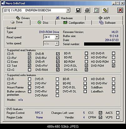

Oto wyjście Nero InfoTool 4.0.3 z numerem seryjnym zredagowanym dla napędu PLDS DS-DS8DCSH:
Here is the Nero InfoTool 4.0.3 output with serial number redacted for the PLDS DS-DS8DCSH drive:

The PLDS DS-8DCSH model is a DVD-ROM that only reads CD and DVD media.
Models: LiteOn DS-8ACSH /LiteOn DS-8ABSH/ TEAC DV-W28S-C are CD and DVD writers with completely different designs.
Only the TEAC DV-28S-C is a clone / OEM of the PLDS DS-8DCSH design and only in this case is there a theoretical possibility of cross-flash provided that you have the firmware in bin format from Teac.
