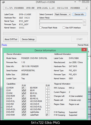

Hello,
i´m trying to crossflash my Pioneer Drive. All tries with DVRTool from Post 1 haven´t worked. I have extracted the Firmware Binarys (131 and 132) from the official Updater but no success to Flash them to the Drive.
I´m looking for the introduced BDRFlash Tool, but couldn´t find it. Can someone help out?
Awesome what you guys are doing here.
Thanks in advance.
BigJoe jest offline
