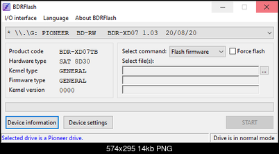

Unfortunatelly Im not able to dump firmware:
Firmware reading is not supported for this drive.
Im not sure if cross-flashing firmware to UHD version of BDR-XD07 will work and will result with UHD support. Also, is English or Polish prefered?
DVRTool v1.0 - firmware flashing utility for Pioneer DVR/BDR drives-bdrflash_bdr-xd07tb_main.png
DVRTool v1.0 - firmware flashing utility for Pioneer DVR/BDR drives-bdrflash_bdr-xd07tb_info.png
File Type: png bdrflash_bdr-xd07tb_main.PNG (13.8 KB, 993 oglądane)
File Type: png bdrflash_bdr-xd07tb_info.PNG (25.3 KB, 924 oglądane)

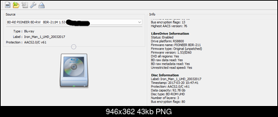

Ha, you got me now.
I didn't test before and was even not sure whether I have a TripleLayer UHD.
Had to check first, but then I found some.
Yes, all 3 Iron Man UHD's are recognized in makeMKV and play also in MPC-HC.
Screenshot attached.
