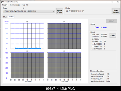

Stary 26.01.2024, 16:10   #7
Posty: 22,768
@jadburner
You will definitely be happy...
PR1ML-C is made and ready for you...
Updated to the latest fw.1.75, works very nicely, tests very well in the Pioneer Error Rate Utility program.....I feel sorry to part with it.......
Do you have Pioneer Error Rate Utility 2.6.1.0? Have I sent you? Because Windows 10 requires this version for proper operation...
czary2mary jest offline
