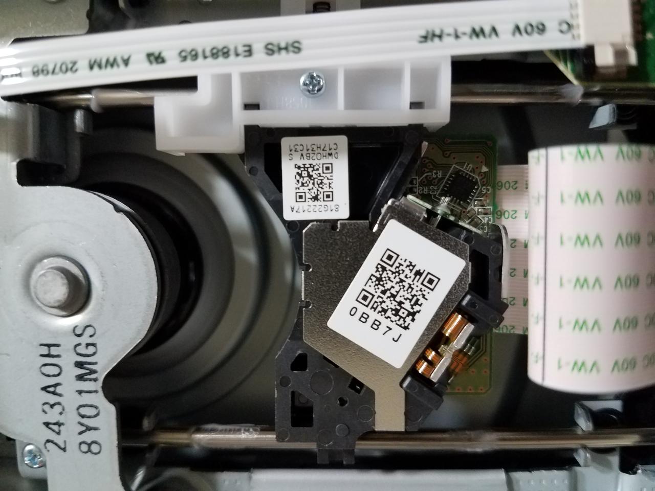

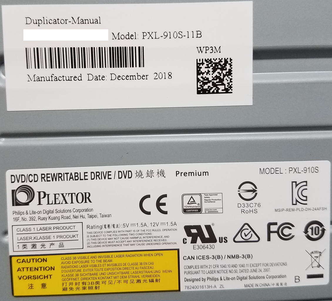

jadburner 17.10.2019 08:05
Ilość załączników: 5
Thank you for the tests, Kirby. :spoko:
I have the same drive, and took some additional photos:
Załącznik 144285
Załącznik 144286
Załącznik 144287
Załącznik 144288
Załącznik 144289
czary2mary 16.10.2019 07:57
@Kirby
Thank you very much for adding the PLEXTOR PXL-910S test.
After technical data it looks like OEM LiteOn iHAS 124 F / PLDS DH24AFSH design
Also on its website Acumen does not offer this model, despite the fact that it sells it on Amazon and Ebay.
http://acumendisc.com/Optical-Drives/PLEXTOR
Can you make a copy of the DosFlash firmware and send it to PW?
