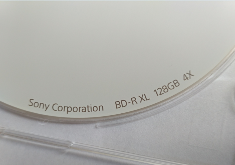

SONY-NQ1 10 pieces spindle (S4PPBD4RB10), from May 2025
burned @ 2x (with DM) WH16NS48, scan @4x
"ring" code: 16DJ1702B

SONY-NQ1, 25 pieces spindle (S4PPGD4RB25) from April 2020 (the case is from Panasonic). Without Sony Corporation Logo
burned @ 2x (with DM) WH16NS48, scan @ 4x
"ring" code:16DD191MV
-> same disk as BNR4VAPS4 from 2018

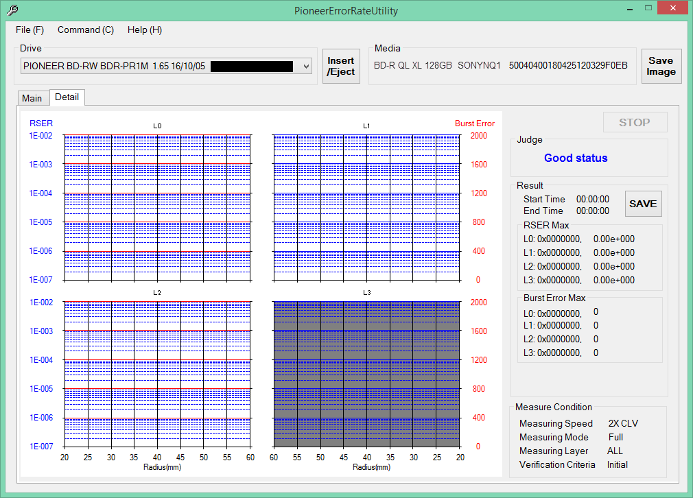

Stingray 18.07.2025 08:40
I have looked many scans of SONY NQ1-001 on this forum and on the internet in general.
the best scans were at 2x write speed, 4x worse, 6x usually even worse.
The scans at 2x are so good, I haven't seen 3 layer 100 gb disks with better results than these 4 layer Sony disks
Pioneer BDR-S12J-X FW 1.01 Imgburn 2x OPC on
retail Sony 128Gb 5 in slim box code -16DJ132SA
Optidrive does not show all picture unfortunately:
https://i.ibb.co/5gB8f7PM/rec.png
https://i.ibb.co/Cs2ssv5N/sony-R128-...e2009pio2x.jpg
Pioneer BDR-S12J-X FW 1.01 Imgburn 2x OPC off
retail Sony 128Gb 5 in clim box code -16DJ132SA
https://i.ibb.co/kVwJCqjr/sony-R128-...o-S12jx-2x.jpg
Pioneer BDR-S12J-X FW 1.03 Imgburn 2x OPC off
cake 25pcs Sony 128Gb code -16DJ1608B
https://i.ibb.co/GfKc2nt8/sony-R128-...jx-2xscan4.jpg

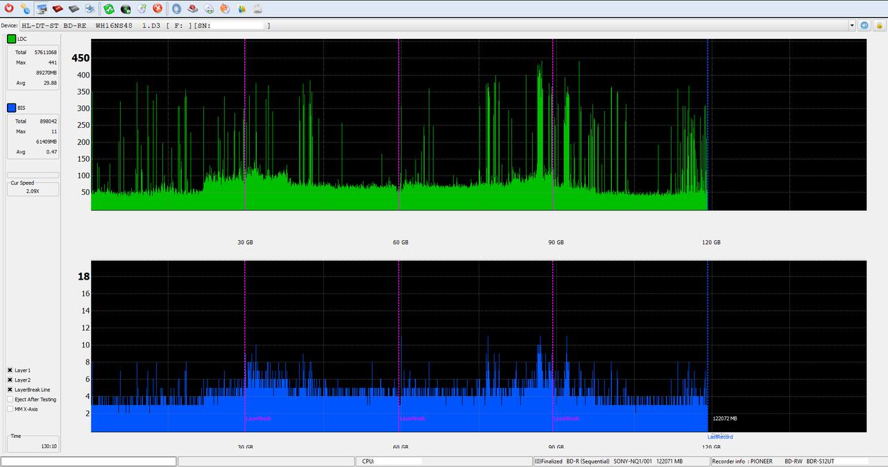

In comparison VERBAT-IMk (burned @2x with DM on WH16NS48, scan @4x)
blackice 16.07.2025 12:39
SONY-NQ1 (burned @2x with DM on WH16NS48, scan @4x)
