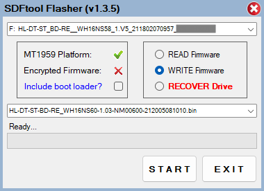

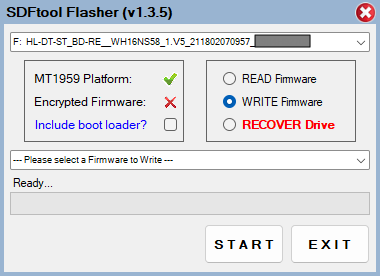

  • Run the SDFtool flasher and select your drive.
Załącznik 210425
  • In the lower drop-down box, select the MK version of the WH16NS60 1.03 firmware to write to the drive. Why the WH16NS60 firmware? For some unknown reason the SDFtool flasher is not able to directly flash the UHD-enabled 1.V5 firmware to the drive. So, this intermediate step is necessary.

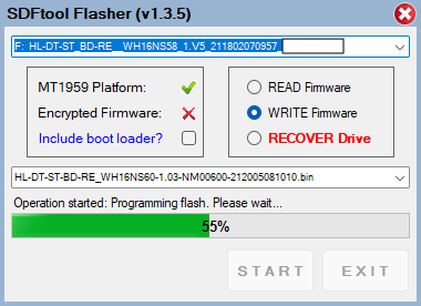

  • Click the START button to start the flashing process.
