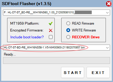

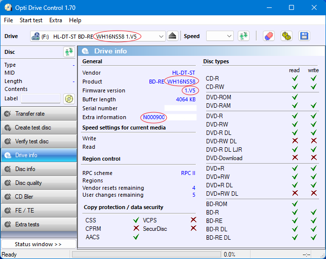

I'll be flashing the following drive with UHD-disabled 1.V5 firmware:
Here's the step by step procedure:
  • Run the SDFtool flasher and select your drive.
  • In the lower drop-down box, select the MK version of the WH16NS60 1.03 firmware to write to the drive. Why the WH16NS60 firmware? For some unknown reason the SDFtool flasher is not able to directly flash the UHD-enabled 1.V5 firmware to the drive. So, this intermediate step is necessary.
  • Click the START button to start the flashing process.
  • When the flashing completes, the drive will now have the WH16NS60 1.03 "MK" firmware.
Flash WH16NS58 to Enable UHD Disc Quality Scanning-step-4-after-flash-wh16ns60-.png
  • Run the SDFtool flasher again, select the drive (which now has the WH16NS60 1.03 "MK" firmware), and in the lower drop-down box select the WH16NS58 1.V5 "MK" firmware.
Flash WH16NS58 to Enable UHD Disc Quality Scanning-step-5-select-wh16ns58-fw-flash-.png
Flash WH16NS58 to Enable UHD Disc Quality Scanning-step-6-during-final-flash-.png
When the flashing is done, the drive will now have the UHD-enabled WH16NS58 1.V5 firmware.
