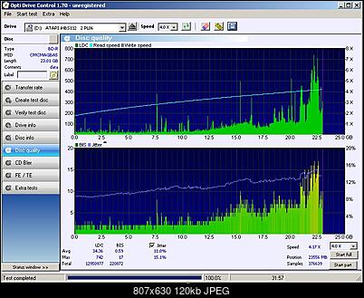

Verbatim BD-R x6 Printable od CMC
Pioneer BDR-S09XLT
Fw. 1.33
Nero 2014
Speed: x4

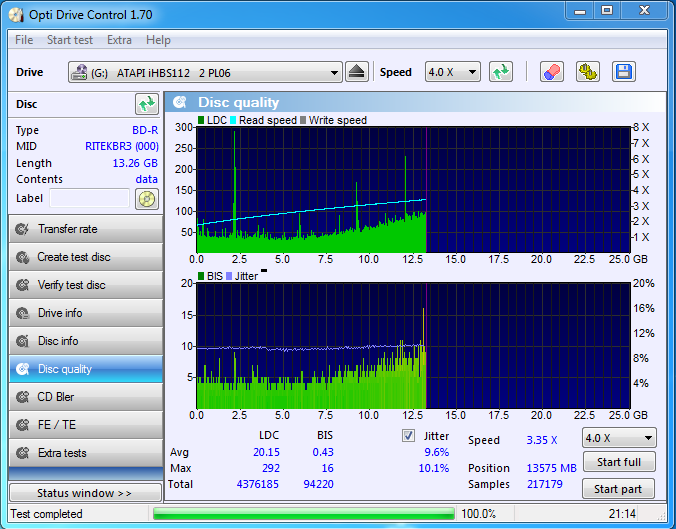

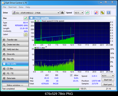

Maxell Blu-Ray BD-R 4x Printable
X4 Pionieer 209D F.W 1.33
Nero 2016
File Type: png Disc_quality2_15-maja-2016.png (86.0 KB, 565 oglądane)
