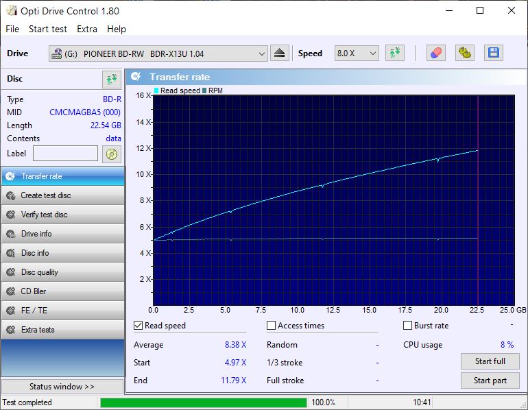

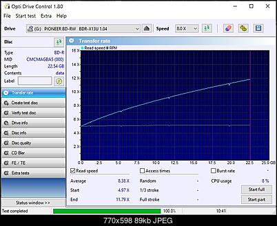

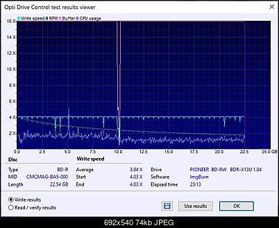

HP 6x BD-R
MID: CMCMAGBA5
BDR-X213 (1.04) (QUALITY MODE)
OPC = Yes
@ 4x
Pioneer BDR-X213 / X13-disc_24h_quality-mode-bdrx13-e-s.jpg
Pioneer BDR-X213 / X13-transfer_bdr-x13e-s.jpg
Pioneer BDR-X213 / X13-write_bdr-x13e-s.jpg
File Type: jpg Disc_24H_quality-mode-bdrx13-e-s.JPG (101.4 KB, 384 oglądane)
File Type: jpg TRANSFER_BDR-X13E-S.jpg (88.6 KB, 385 oglądane)
File Type: jpg WRITE_BDR-X13E-S.jpg (73.5 KB, 348 oglądane)

I've recently recorded about 100 discs with this MID code on 2 Pioneers.
it seems for me OPC better to switch off and all quality options in Pioneer utility also off.

Discs w/o layer break (25GB) are usually a no brainer for any BD drive. Even using a LG drive.
Coopervid jest offline   Odpowiedz cytując ten post
Stary 09.09.2024, 15:10   #8
Stingray
Data rejestracji: 12.02.2024
Posty: 182
Stingray zaczyna zdobywać reputację <1 - 49 pkt>
Napisany przez Coopervid Podgląd Wiadomości
YES, but without OPC I received constantly lower LDC|BIS.
as about LG, recently I checked also a jitter and was surprised ASUS 16 FW3.11 on 4x has better jitter with CMCMAGBA5 than 2 my Pioneers at any speed
based on my table for CMCMAGBA5:
ASUS16 4x - Jitter avg 9,1%
Pio205 6x -10,1% (at lower speed jitter is higher for example for 2x -12,2%), but LDC|BIS are better at 2x
PioS12 2x - 9,6% (at higher speed jitter is higher)
Ostatnio zmieniany przez Stingray : 09.09.2024 o godz. 16:10

I never noticed read failures based on jitter. Only based on LDC / BIS. We had some discussions about critical LDC / BIS values on a PM base in the other forum.
Stary 09.09.2024, 18:41   #10
Stingray
Posty: 182
Yes I remember thank you.

Coopervid is correct. Jitter does not seem to affect the readability of a Blu-ray disc. This is also my conclusion after burning and testing several thousand Blu-ray discs. The far more relevant and useful tests are LDC/BIS and a read test (TRT).
I'm not arguing, I was just surprised that ASUS/LG writes with better jitter

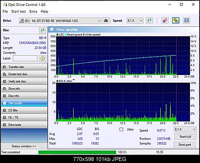

Thanks. That's a lot of information. Are you able to post a single DQ scan for the 205 and one for the 212J-X, burned at the same speed? Also, could you post as PNG instead of JPG? PNG scales better when zooming in. Thanks.
Stary 09.09.2024, 23:11   #15
Stingray
Posty: 182
same MID as mentioned before
I picked almost the best scans
Pioneer BDR-205 FW1.12 2x off
jitter
Pioneer BD-R-S12Jx FW 1.01 2x off
jitter
