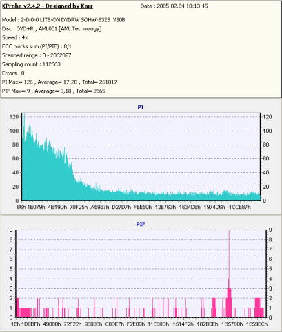

Obiecane testy
Esperanza DVD+R x4 FW06 AML001 burn x8 1620B7T9 @AML003
File Type: png Kopia Esperanzax4+RFW06B7T9(x8)AML003+VS0B.PNG (49.3 KB, 176 oglądane)

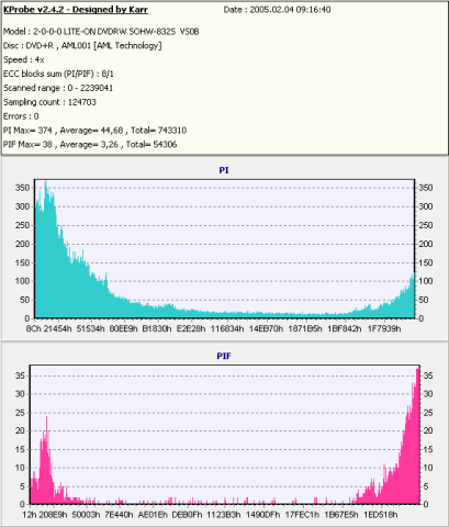

Esperanza DVD+R x4 FW06 AML001 burn x8 1620B7T9 @AML002
File Type: png Kopia Esperanzax4+RFW06B7T9(x8)AML002+VS0B.PNG (49.0 KB, 177 oglądane)
