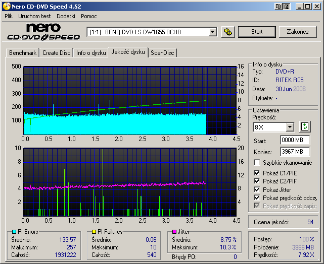

Verbatim DVD+RW x4 palona 4x na BenQ LS DW1655 BCIB
http://img101.imageshack.us/img101/4...0061714to7.png
http://img101.imageshack.us/img101/5...0061731zy0.png
http://img101.imageshack.us/img101/7...0061743xu3.png
