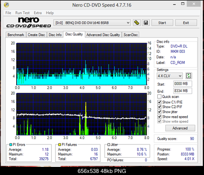

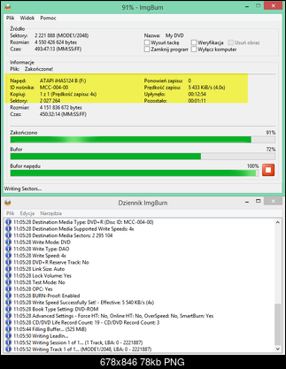

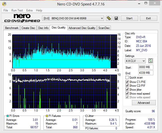

2,4x@ iHAS124 B AL0S
ImgBurn 2.5.8.0
Kodak DVD+R DL

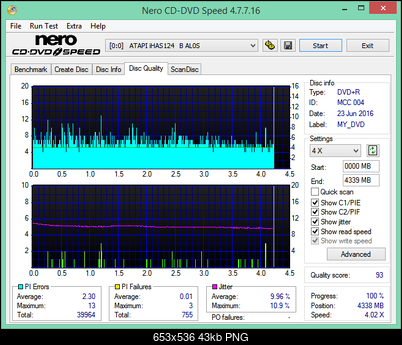

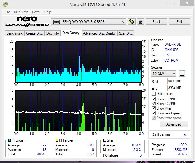

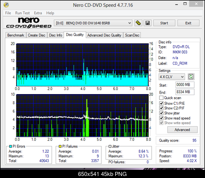

Verbatim DVD+R DL MKM003 Made in UAE \ FalconMedia
LiteOn iHAS 124 B fw.AL0S
ImgBurn 2.5.8.0 x4
