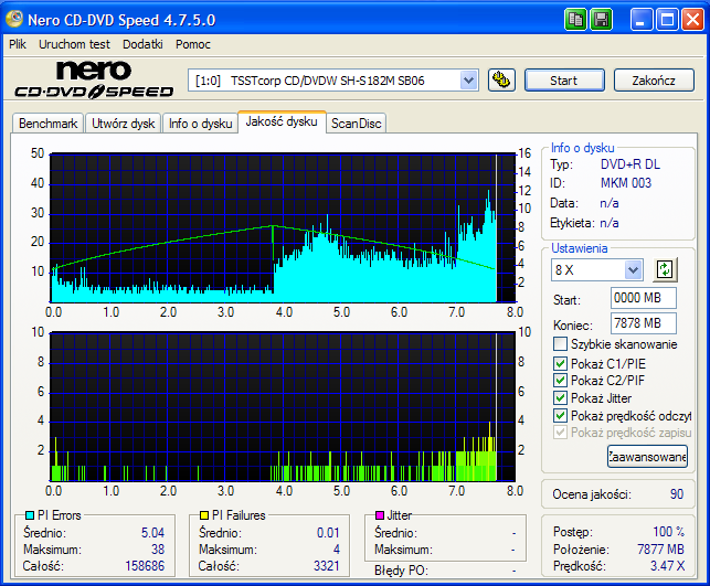

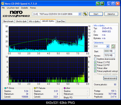

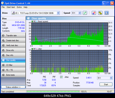

Stary 04.12.2009, 18:27   #1026
Verbatim +R DL 8x palony 6x Pioneer 215@S15J 1.22 UDF 1.02 Nero 9.4.26.0
Pioneer DVR-115\-A15\-215 \-S15-verbatim-r-dl-8x-6x-pioneer-215-s15j-1.22.png
Verbatim +R DL 2.4x palony 4x Pioneer 215@S15J 1.22 UDF 1.02 Nero 9.4.26.0
Pioneer DVR-115\-A15\-215 \-S15-verbatim-r-dl-2x-4x-pioneer-215-s15j-1.22.png
