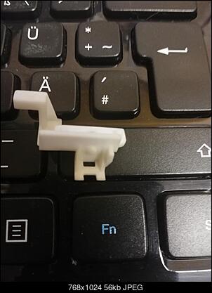

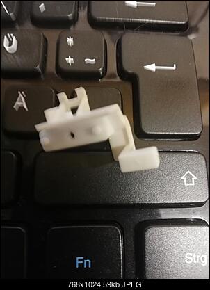

Plextor 760 A Plastic for Laser
Hello all,
i replaced the Laser in my Plextor 760a. My Problem is, the Plastic that drives forward and back is broken.
Where can i get this piece of plastic?
Maybe someone with a 3D Printer can make a new one for me.
I added two Pictures.
Greetings Kirby
File Type: jpg IMG_20200421_215904_resized_20200421_095950726.jpg (59.0 KB, 49 oglądane)
File Type: jpg IMG_20200421_215916_resized_20200421_095949997.jpg (56.0 KB, 51 oglądane)
Kirby jest offline   Odpowiedz cytując ten post
Stary 22.04.2020, 08:46   #4
Posty: 22,776
Difficult case ... you can't buy a new one anywhere.
Only from damaged old Plextor PX-755 \ 760 models you need to look. On the 3D printer you need to make an exact sketch with dimensions .. it will certainly cost a lot ...
