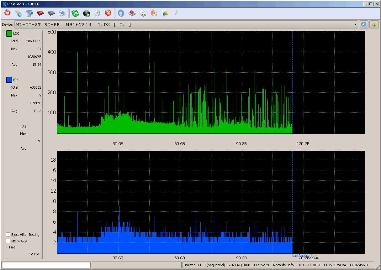

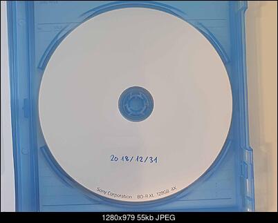

SONY-NQ1 slimline case 5-Pack BNR4VAPS4 from end of 2018 (the case is from Panasonic).
burned @ 2x (with DM) WH16NS48, scan @4x
"ring" code:16DD191MV
Sony  BD-R XL QL 128GB MID:SONYNQ1-sony-nq1_bnr4vaps4_20181231.jpg   Sony  BD-R XL QL 128GB MID:SONYNQ1-sony-nq1_bnr4vaps_wh16ns48_2x_withdm_wh16ns48_4x.jpg

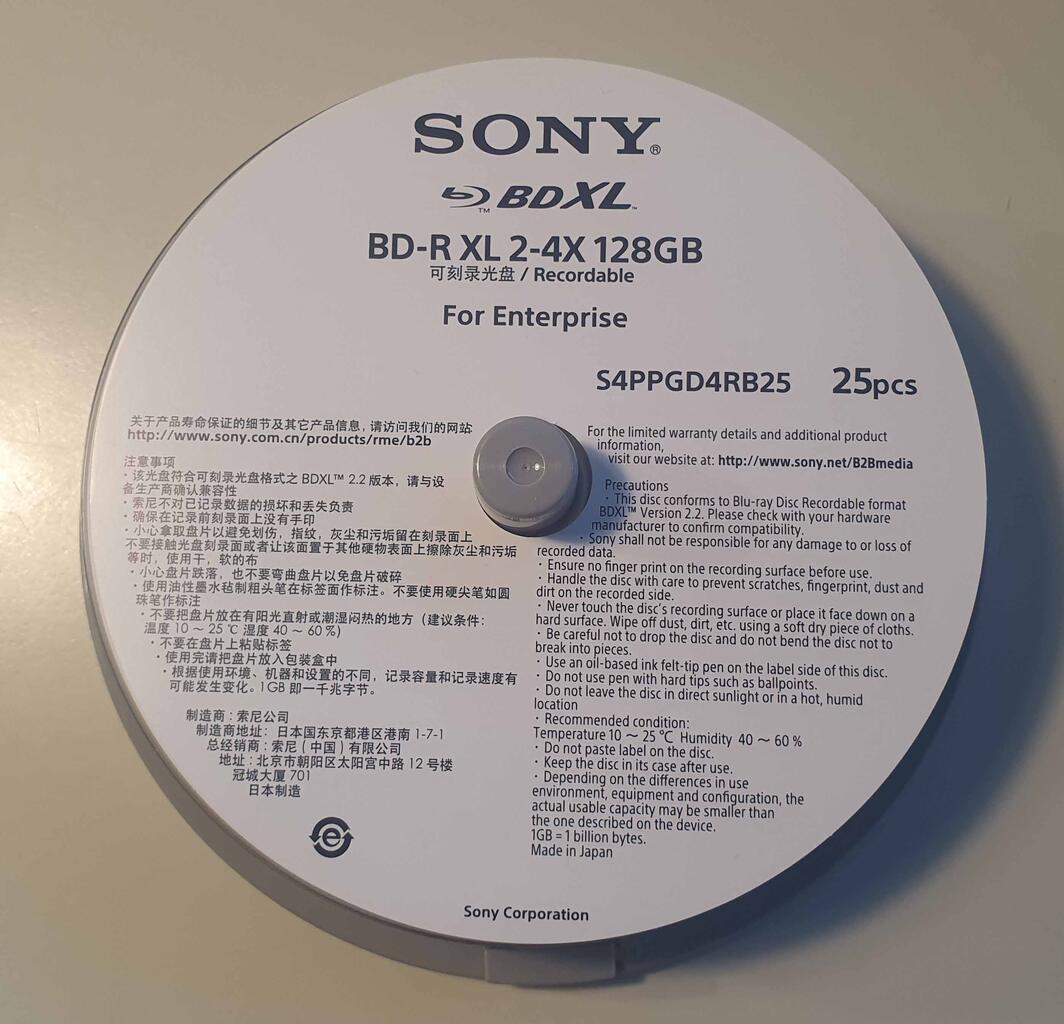

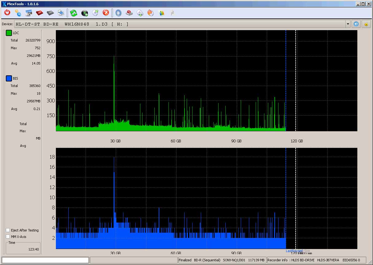

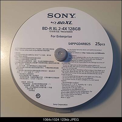

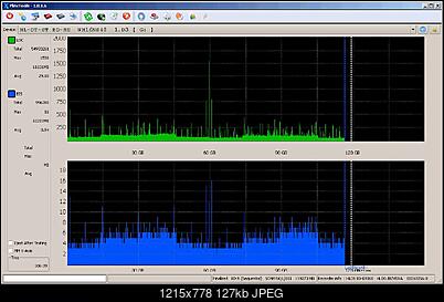

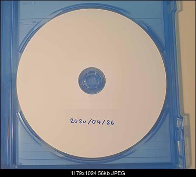

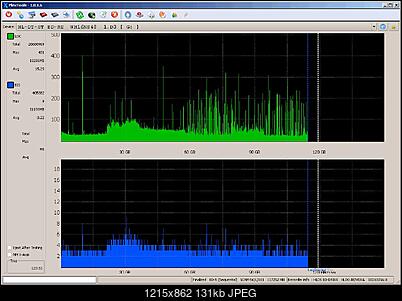

SONY-NQ1, 25 pieces spindle (S4PPGD4RB25) from April 2020 (the case is from Panasonic). Without Sony Corporation Logo
burned @ 2x (with DM) WH16NS48, scan @ 4x
-> same disk as BNR4VAPS4 from 2018
Sony  BD-R XL QL 128GB MID:SONYNQ1-sony-nq1_s4ppgd4rb25_20200426.jpg   Sony  BD-R XL QL 128GB MID:SONYNQ1-sony-nq1_s4ppgd4rb25_cake_1.jpg   Sony  BD-R XL QL 128GB MID:SONYNQ1-sony-nq1_s4ppgd4rb25_cake_2.jpg   Sony  BD-R XL QL 128GB MID:SONYNQ1-sony-nq1_wh16ns48_2x_withdm_wh16ns48_4x.jpg

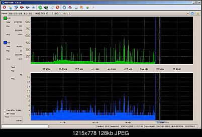

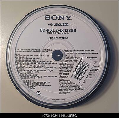

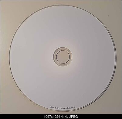

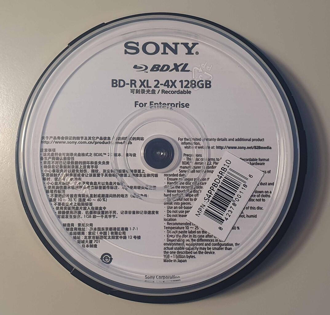

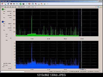

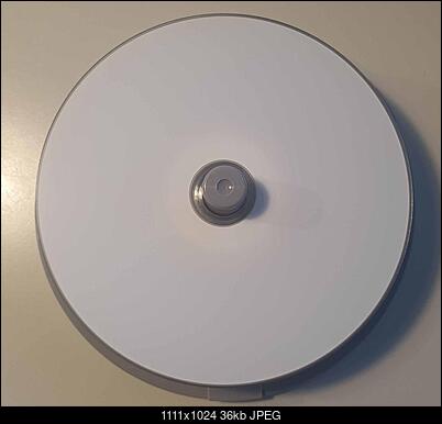

SONY-NQ1 10 pieces spindle (S4PPBD4RB10), from May 2025
"ring" code: 16DJ1702B
Sony  BD-R XL QL 128GB MID:SONYNQ1-sony-nq1_s4ppbd4rb10.jpg   Sony  BD-R XL QL 128GB MID:SONYNQ1-sony-nq1_s4ppbd4rb10_cake.jpg   Sony  BD-R XL QL 128GB MID:SONYNQ1-sony-nq1_wh16ns48_2x_withdm_wh16ns48_4x.jpg

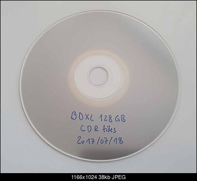

SONY-NQ1 from ODC1500R cartridge from July 2017 (retail version of Sony 128GB discs weren't available at that time!)
burned @4x (no DM) WH16NS48, scan @6x
no "ring" code, but some kind of stamper code for each layer in the BCA (very, very hard to see....!)
PDQ-0005-L0-1
PDQ-1015-L1-1 (no typo, really 1015)
PDQ-2005-L2-1
PDQ-3005-L3-1
Sony  BD-R XL QL 128GB MID:SONYNQ1-sony-nq1_odc1500r_20170718.jpg   Sony  BD-R XL QL 128GB MID:SONYNQ1-sony-nq1_odc1500r_wh16ns48_4x_nodm_wh16ns48_6x.jpg
