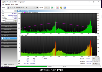

Verbatim 2x BD-RE DL
Lite-On iHBS212 2 HL05, 45.11 GB burned at 1x speed
sold as "Verbatim 2x BD-RE DL"
MID: VERBATIM1 (000)
manufactured in Taiwan by CMC Magnetics
Thank you to EZ647 for sending this disc.

Hi, Did you burned it on the Liteon ?
I ordered myself a dozen of these to use them on a UD04FAL and BU40N.

Yes, but so far I've only tried this burn-in test at 1x speed (I think I have something set up wrong in Opti Drive Control).

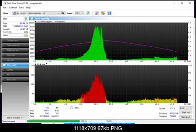

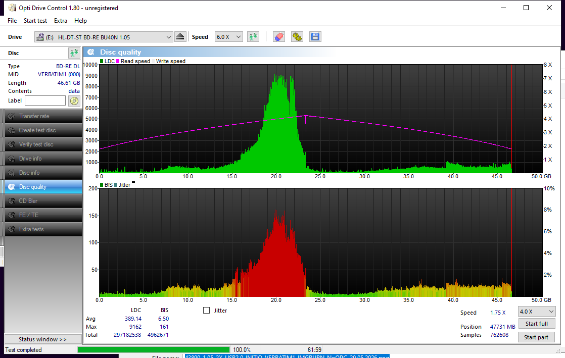

Burned on verbatim 43890 (bu40n fw 1.05)
Imgburn 2.5.8 no OPC 2x fast write enabled.

Terrible results - even worse than mine (and mine were bad enough). These media are barely usable. It seems that we aree truly witnessing the twilight of optical media.

@Stingray, that is like night and day.
I've got a new burner and tested again the same disc - s12uht fw1.02 @2X
This media is bad.
