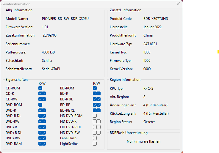

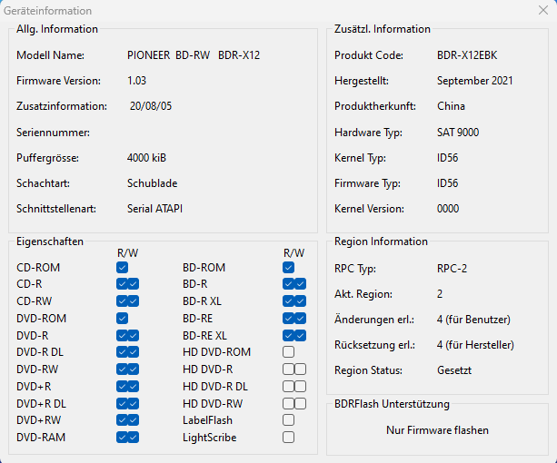

Yes, i would like to crossflash a Pioneer BDR-S09XLT into some kind of S11 to become UHD-friendly (Sat8600, ID43, FW 1.34, Sata)
After looking in my old lab, I found several other Pioneer drives.
Maybe you can give me some further hints to improve them (maybe UHD-friendly too, crossflash to newer models and so on).
Pioneer BDR-X12EBK (Sat9000, ID56, FW 1.03, USB)
Pioneer BDR-XS07TUHD (Sat8E21, ID05, FW 1.01, USB SlotIn)
Pioneer BDR-UD04 (Sat8A10, IDGeneral?, FW 1.14, USB - Verbatim 43888)
Pioneer BDR-S08XLT (Sat8301, ID43, FW 1.50, Sata)

Crossflash BDR-209EBK to BDR211EBK-pioneer-bdr-s09xlt.png   Crossflash BDR-209EBK to BDR211EBK-pioneer-bdr-x12.png   Crossflash BDR-209EBK to BDR211EBK-pioneer-bdr-xs07u.png   Crossflash BDR-209EBK to BDR211EBK-pioneer-bdr-ud04.png   Crossflash BDR-209EBK to BDR211EBK-pioneer-bdr-s08xlt.png

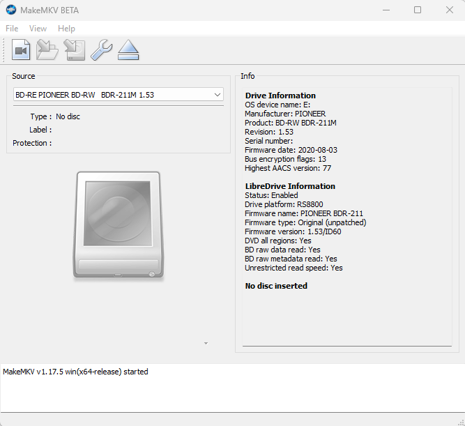

crossflash from Pioneer BDR-S09XLT to Pioneer BDR-211M worked.
Product-Code is still BRD-S09XLT, but Kernel and Firmware are shown as SAT8800 ID60.
I thank you for your help!

Crossflash BDR-209EBK to BDR211EBK-pioneer-s09xlt-crossflashed-1.png   Crossflash BDR-209EBK to BDR211EBK-pioneer-s09xlt-crossflashed-2.png   Crossflash BDR-209EBK to BDR211EBK-pioneer-s09xlt-crossflashed-3.png

Another crossflash of an BDR-S08XLT to an BDR-211M
Thanks to jadburner
Crossflash BDR-209EBK to BDR211EBK-pioneer-bdr-s08xlt-after-1.png   Crossflash BDR-209EBK to BDR211EBK-pioneer-bdr-s08xlt-after-2.png   Crossflash BDR-209EBK to BDR211EBK-pioneer-bdr-s08xlt-after-3.png
