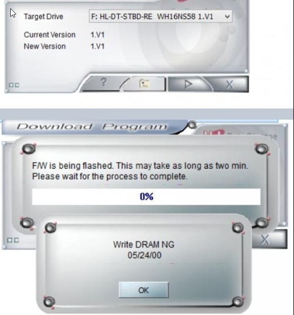

The sample test demonstrates the firmware downgrade on VinPower version of WH16NS58 drive with installed 1.V1-02 firmware. In this version LG has blocked the possibility of firmware downgrade using the unlocked flasher: if you will try, you will get an infamous "Write DRAM NG 05/24/00" error.

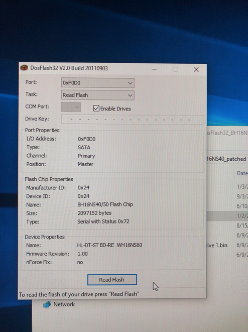

2. Read flash from your drive using patched DosFlash, selecting "Read Flash" in Task combobox and clicking the button with same name. If flash was successfully read, go to next step.
Załącznik 111613

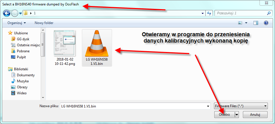

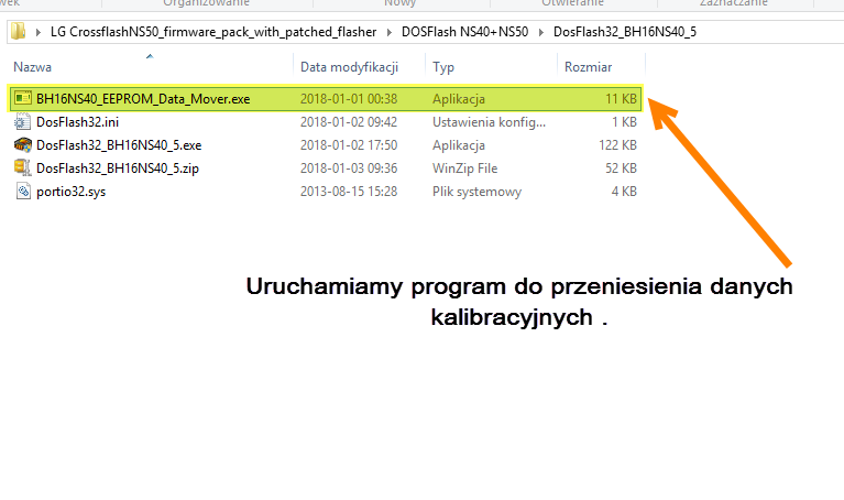

3. Prepare the clean firmware you want to flash into your drive (e.g. extracted from the official LG flashing utility). Execute "BH16NS40_EEPROM_Data_Mover.exe", which is bundled with patched DosFlash in the same archive. Select the firmware you just dumped with DosFlash (note that a dump made by DevilsClaw's Flasher will also work), then select the clean firmware you want to flash, then select the location where to save the firmware, prepared for flashing with DosFlash. It will be made of clean firmware you want to flash and the EEPROM data, transferred from the dump you made from your drive.
Załącznik 111614

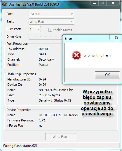

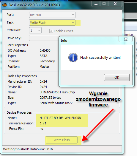

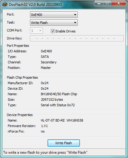

4. Now the most important part: flashing the drive with a prepared firmware. Select "Write Flash" in a Task combobox and click the button, then select your prepared firmware. Now, if you're lucky, flash image will be written and your drive will become functional with new firmware. If DosFlash reports about write errors, try flash the firmware again: it's not uncommon to have the flash correctly written from third or fourth try. When the flash will be successfully written, you can read it from your drive again and compare with the prepared firmware byte-by-byte: they should be identical.
Załącznik 111619
Załącznik 111620
Załącznik 111621

W przykładowym teście przywrócono oprogramowanie wcześniejsze w modelu VinPower LG WH16NS58 fw.1.V1 z najnowszej aktualizacji 1.V1-02 blokującej taką możliwość i informującej o błędzie Write DRAM NG

2. Odczytaj (read) firmware wraz z danymi kalibracyjnymi z napędu używając DosFlash, wybierając "Read Flash" i klikając przycisk o tej samej nazwie poniżej. Jeśli flash został pomyślnie odczytany, przejdź do następnego kroku.
Załącznik 111485
3. Przygotuj "czyste" oprogramowanie firmware , które chcesz wczytać\wgrać do napędu (np. z tematu Crossflash Blu-Ray LG serii NS50/NS51/NS55/NS58). W programie "BH16NS40_EEPROM_Data_Mover.exe", który jest dołączony do zmodernizowanej wersji DosFlash w tym samym archiwum wybierz najpierw oprogramowanie, które właśnie zgrałeś za pomocą DosFlash ze swojego napędu , następnie wybierz czyste oprogramowanie firmware do crossflash , które chcesz wgrać a następnie wybierz lokalizację, w której chcesz zapisać to oprogramowanie. W taki sposób powstanie prawidłowy firmware do zapisania przy pomocy DosFlash. Zostanie to wykonane z czystego oprogramowania, i danych EEPROM, przeniesionych ze kopii firmware który zrobiłeś ze swojego napędu .
Załącznik 111599
Załącznik 111486

4. Teraz najważniejsza część: wgranie do napędu za pomocą przygotowanego oprogramowania. Wybierz "Write Flash" w comboboxie Task i kliknij przycisk poniżej , a następnie wybierz przygotowane firmware. Teraz, jeśli masz szczęście, zostanie zapisany nowy firmware , a twój napęd będzie działał z nowym oprogramowaniem układowym. Jeśli DosFlash zgłasza błędy zapisu, spróbuj ponownie flashować oprogramowanie: często zdarza się, że flash\firmware jest poprawnie zapisany przy kolejnej lub trzeciej lub czwartej próbie. Kiedy flash \firmware zostanie pomyślnie napisany, możesz go ponownie odczytać z napędu za pomocą DosFlash i porównać z przygotowanym wcześniej flash\firmware : powinny być identyczne.
Załącznik 111490
Załącznik 111491
Załącznik 111492

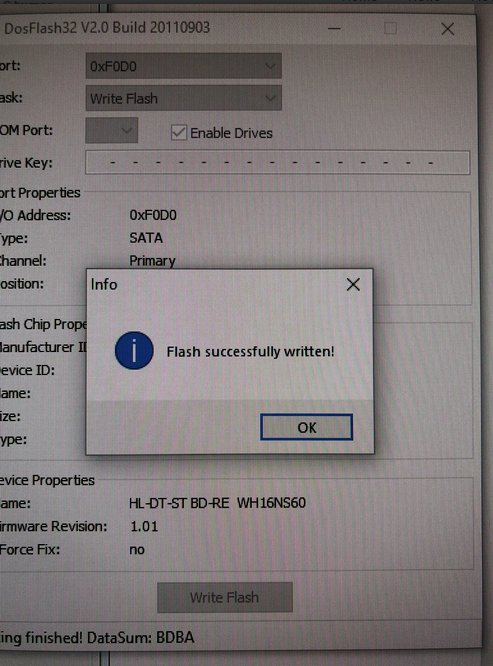

Udało mi się bez błędów cofnąć do FW 1.02, za kilkanaście minut będę crossował do BH16NS58.
Jedna ważna informacja: dopiszcie w instrukcji, że po flashowaniu trzeba zrobić restart systemu, bo inaczej nie wykrywa napędu.

rancor 03.01.2018 22:39
Crossflash do wersji BH16NS58 udany. Testy płyt zapodam jutro, dzisiaj już sobie odpuszczam nagrywanie.

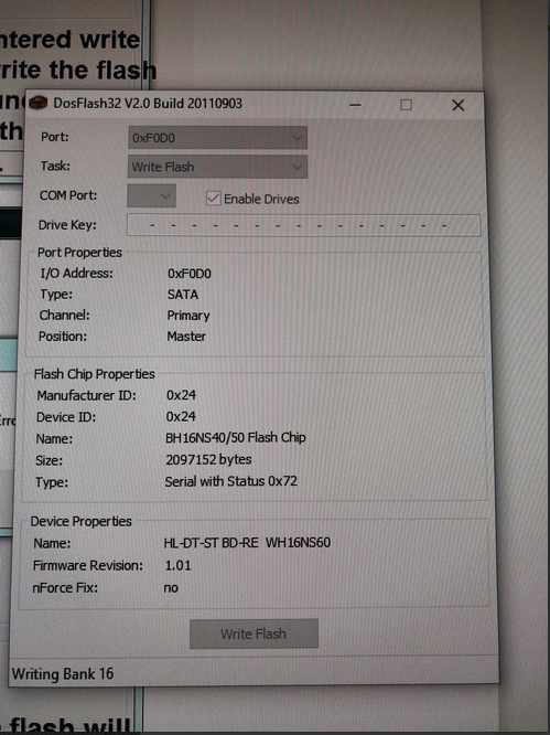

LG WH16NS60 \ LG BH16NS60 LG BU40N
Ilość załączników: 3
Dziękujemy @character82 za test i potwierdzenie działania na tych najnowszych konstrukcjach LG :spoko:
