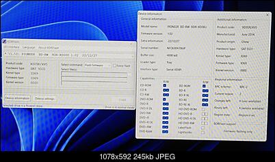

Just successfully converted my S11 to S11JX with firmware dated 2023-02-08, revision 1.54.
put in a 4K UHD disc to rip, and its working!!

Stary 09.10.2026, 06:48   #2
cashkey1
Data rejestracji: 25.01.2025
Posty: 139
cashkey1 w tym momencie nie ma Reputacji dodatnich ani ujemnych <0  pkt>
the ID was initially ID43, but with this firmware flash, it has now changed to ID72.

Stary 09.10.2026, 07:03   #3
mattjackson
Data rejestracji: 29.09.2026
Posty: 146
mattjackson zaczyna zdobywać reputację <1 - 49 pkt>
Yea ID is in the firmware downloaded and flashed. Its listed on website.
As far as I can tell it doesnt really mean much. Not something I have looked into a ton but seems low priority for flashing.
mattjackson jest offline   Odpowiedz cytując ten post

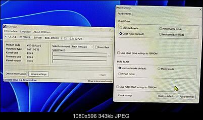

Stary 09.10.2026, 09:08   #7
cashkey1
Posty: 139
pictures.
File Type: jpg IMG_20261009_092552.jpg (245.4 KB, 12 oglądane)
File Type: jpg IMG_20261009_092612.jpg (342.5 KB, 10 oglądane)
