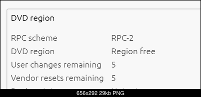

Something like this?

Stary 10.10.2026, 04:49   #11
Flowery
Data rejestracji: 28.09.2026
Posty: 21
Flowery w tym momencie nie ma Reputacji dodatnich ani ujemnych <0  pkt>
Pretty much! The MediaTek drive I saw had it like 'Region: 1, 2, 3, 4, 5, 6, 7, 8'
This might only be useful for legacy software, but still nice to have.
Flowery jest online   Odpowiedz cytując ten post

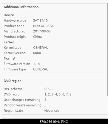

Stary 10.10.2026, 05:08   #15
Flowery
Posty: 21
Looks good! Does changing the region like this, mess with the firmware in any way? Or is the region code stored elsewhere?
