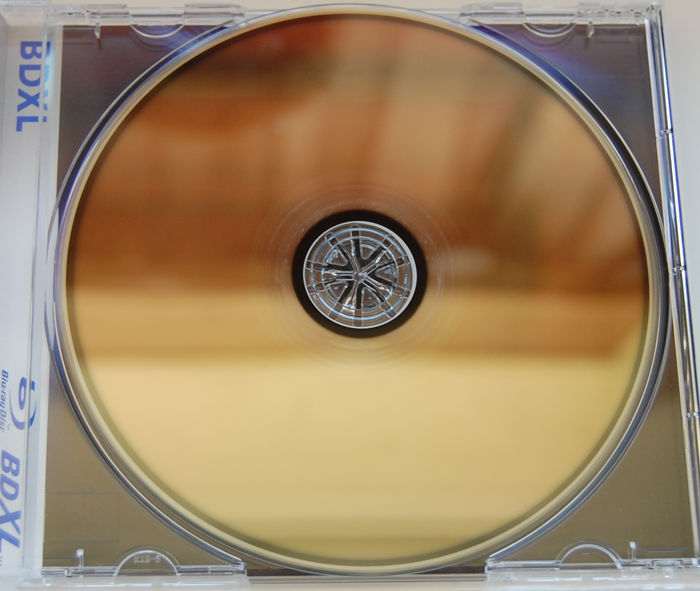

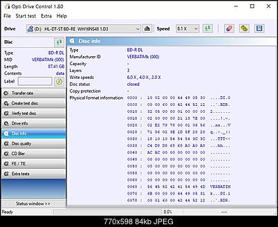

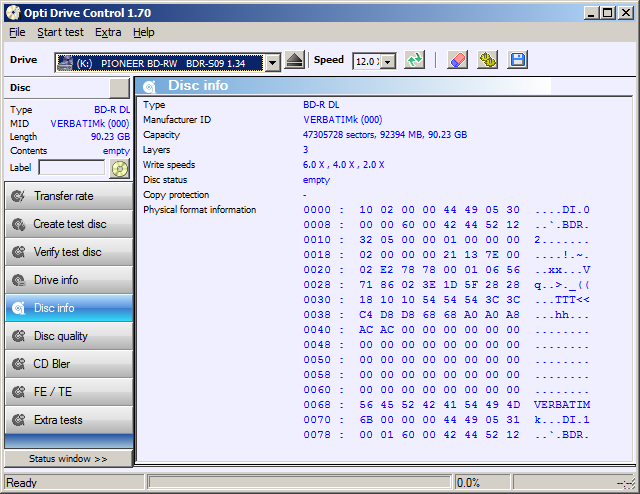

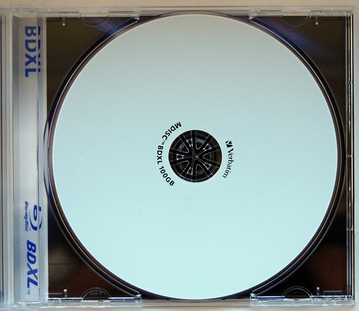

Verbatim M-Disc BDXL 100 GB x4 Printable MID: VERBAT-IMk-000 (Made In Japan)
MID: VERBAT-IMk-000
Made In Japan
Verbatim M-Disc BDXL 100 GB x4 Printable MID: VERBAT-IMk-000 (Made In Japan)-01_front.png
Verbatim M-Disc BDXL 100 GB x4 Printable MID: VERBAT-IMk-000 (Made In Japan)-02_back.png
Verbatim M-Disc BDXL 100 GB x4 Printable MID: VERBAT-IMk-000 (Made In Japan)-03_topl.png
Verbatim M-Disc BDXL 100 GB x4 Printable MID: VERBAT-IMk-000 (Made In Japan)-04_madeinjpn.png
Verbatim M-Disc BDXL 100 GB x4 Printable MID: VERBAT-IMk-000 (Made In Japan)-05_disctop.png
Verbatim M-Disc BDXL 100 GB x4 Printable MID: VERBAT-IMk-000 (Made In Japan)-05b_discbtm.png
Verbatim M-Disc BDXL 100 GB x4 Printable MID: VERBAT-IMk-000 (Made In Japan)-06_infodip.png
Verbatim M-Disc BDXL 100 GB x4 Printable MID: VERBAT-IMk-000 (Made In Japan)-07_infoodc.png
Verbatim M-Disc BDXL 100 GB x4 Printable MID: VERBAT-IMk-000 (Made In Japan)-08_infoib.png

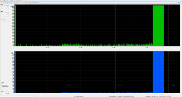

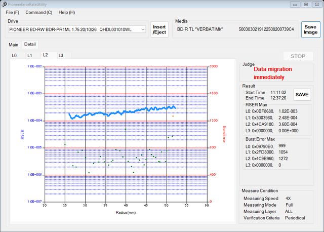

Stary 14.10.2024, 12:58   #2
Quintam
Data rejestracji: 16.06.2023
Lokalizacja: Zamość
Posty: 21
Quintam zaczyna zdobywać reputację <1 - 49 pkt>
Thumbs up

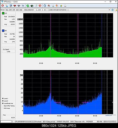

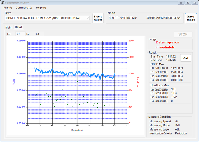

MID: VERBAT-IMk-000
Made in Taiwan
Pioneer BDR-X13E-S (1.04) (QUALITY MODE)
Imgburn x4
OPC: YES
Kod:
 Disc Information:
Status: Complete
State of Last Session: Complete
Erasable: No
Sessions: 1
Sectors: 45 829 664
Size: 93 859 151 872 bytes
Time: 10184:24:14 (MM:SS:FF)
MID: VERBAT-IMk-000
Supported Write Speeds: 2x; 4x; 6x
TOC Information:
Sesja 1... (LBA: 0)
-> Track 01  (Mode 1, LBA: 0 - 45829663)
-> LeadOut  (LBA: 45829664)
Disc Definition Structure:
Certified: No
Scanned: No
Manufacturers Name: PIONEER
Additional ID: BD-RW BDR-X13U
Serial Number: CEDL000357WL
BD Disc Information (L0):
Disc ID: VERBAT-IMk-000
Disc Type: BD-R
Disc Size: 120 mm
Disc Class: 1
Disc Version: 2
Number of Layers: 3
Layer Type: Writable
DVD Layer Present: No
CD Layer Present: No
Channel Bit Length: 55.87 nm (33 GB Per Layer)
Push-Pull Polarity: Positive
Recorded Mark Polarity: HTL
BCA Present: Yes
Maximum Transfer Rate: Not Specified
First PAA of Data Zone: 554 925 568
Last PAA of Data Zone: 48 396 408
BD Disc Information (L1):
Disc Type: BD-R
Disc Size: 120 mm
Disc Class: 1
Disc Version: 2
Number of Layers: 3
BCA Present: Yes
First PAA of Data Zone: 2 113 928 704
BD Disc Information (L2):
Disc Type: BD-R
Disc Size: 120 mm
Disc Class: 1
Disc Version: 2
Number of Layers: 3
BCA Present: Yes
First PAA of Data Zone: 2 702 409 216
Last PAA of Data Zone: 48 393 838
Layer Information:
Layer 0 Sectors: 629 237 088 (1373%)
Layer 1 Sectors: 1 042 113 888 (2274%)
Layer 2 Sectors: 2 669 445 984 (5825%)
Format Capacities:
DT: 0x02 - NB: 48878592 (0x02E9D400) - TDP: 0
Performance (Write Speed):
Descriptor 1...
-> B0: 0x00; B1: 0x00; B2: 0x00; B3: 0x00
-> EL: 48878591 (0x02E9D3FF)
-> RS: 26 976 KB/s (6x) - WS: 8 992 KB/s (2x)
Descriptor 2...
-> RS: 26 976 KB/s (6x) - WS: 17 984 KB/s (4x)
Descriptor 3...
-> RS: 26 976 KB/s (6x) - WS: 26 976 KB/s (6x)
Verbatim M-Disc BDXL 100 GB x4 Printable MID: VERBAT-IMk-000 (Made In Japan)-mdisc_bdxl_verbatim_14.10.2024_opc.jpg   Verbatim M-Disc BDXL 100 GB x4 Printable MID: VERBAT-IMk-000 (Made In Japan)-mdisc_bdxl_verbatim_14.10.2024_2.jpg
