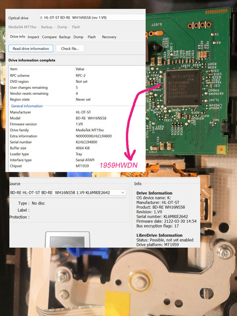

It's strange why does your program find 1939 here?
MT1959UWDN =1939
MT1959HWDN = 1959
Stingray jest offline   Odpowiedz cytując ten post

Thats a good question Let me dig in
0.12.2 due today, found a regression in 0.12.1 the second i released it. typical. not harmful just not as useful.
mattjackson jest offline   Odpowiedz cytując ten post

Napisany przez mattjackson Podgląd Wiadomości
0.12.2
thank you. but err log the same:
...[ 3.870s] SCSI execute: device="\\\\.\\CdRom2" cdb=[3c, 06, 00, 1f, 70, 00, 00, 10, 00, 00] direction=FromDevice requested=4096 timeout_ms=30000
[ 3.875s] SCSI incoming data: reported=Some(4096) buffer_bytes=4096 inspected_bytes=4096 sha256=f47a8ec3e9aff2318d896942282ad4fe37d6391c829 14f54a5da8a37de1300c6 count_known=true status_ok=true
[ 3.875s] SCSI result: status=0x00 transferred=4096 sense=[00, 00, 00, 00, 00, 00, 00, 00, 00, 00, 00, 00, 00, 00, 00, 00, 00, 00, 00, 00, 00, 00, 00, 00, 00, 00, 00, 00, 00, 00, 00, 00] elapsed_ms=5
[ 3.875s] SCSI request: device=\\.\CdRom2 cdb=[3c, 06, 00, 1f, 80, 00, 00, 10, 00, 00] direction=FromDevice requested=4096 attempt=1 strict=false timeout_ms=30000
[ 3.875s] SCSI execute: device="\\\\.\\CdRom2" cdb=[3c, 06, 00, 1f, 80, 00, 00, 10, 00, 00] direction=FromDevice requested=4096 timeout_ms=30000
[ 3.879s] SCSI incoming data: reported=Some(4096) buffer_bytes=4096 inspected_bytes=4096 sha256=5e4c78746fd3d4d452e997c199cf05e64bfbf388823 f989c4c4aa4d19cb8f1e1 count_known=true status_ok=true
[ 3.879s] SCSI result: status=0x00 transferred=4096 sense=[00, 00, 00, 00, 00, 00, 00, 00, 00, 00, 00, 00, 00, 00, 00, 00, 00, 00, 00, 00, 00, 00, 00, 00, 00, 00, 00, 00, 00, 00, 00, 00] elapsed_ms=3
[ 3.879s] SCSI request: device=\\.\CdRom2 cdb=[3c, 06, 00, 1f, 90, 00, 00, 10, 00, 00] direction=FromDevice requested=4096 attempt=1 strict=false timeout_ms=30000
[ 3.879s] SCSI execute: device="\\\\.\\CdRom2" cdb=[3c, 06, 00, 1f, 90, 00, 00, 10, 00, 00] direction=FromDevice requested=4096 timeout_ms=30000
[ 3.882s] SCSI incoming data: reported=Some(4096) buffer_bytes=4096 inspected_bytes=4096 sha256=9e5a57f5f6567951bfc6c8165d41e20b1bc665943a6 9406a744530bfe1701a14 count_known=true status_ok=true
[ 3.882s] SCSI result: status=0x00 transferred=4096 sense=[00, 00, 00, 00, 00, 00, 00, 00, 00, 00, 00, 00, 00, 00, 00, 00, 00, 00, 00, 00, 00, 00, 00, 00, 00, 00, 00, 00, 00, 00, 00, 00] elapsed_ms=3
[ 3.882s] SCSI request: device=\\.\CdRom2 cdb=[3c, 06, 00, 1f, a0, 00, 00, 10, 00, 00] direction=FromDevice requested=4096 attempt=1 strict=false timeout_ms=30000
[ 3.882s] SCSI execute: device="\\\\.\\CdRom2" cdb=[3c, 06, 00, 1f, a0, 00, 00, 10, 00, 00] direction=FromDevice requested=4096 timeout_ms=30000
[ 3.886s] SCSI incoming data: reported=Some(4096) buffer_bytes=4096 inspected_bytes=4096 sha256=ab102825e15b21c975d0eebcadd0a0b4b1608646c85 354b02c03333e9aca3e3d count_known=true status_ok=true
[ 3.886s] SCSI result: status=0x00 transferred=4096 sense=[00, 00, 00, 00, 00, 00, 00, 00, 00, 00, 00, 00, 00, 00, 00, 00, 00, 00, 00, 00, 00, 00, 00, 00, 00, 00, 00, 00, 00, 00, 00, 00] elapsed_ms=3
[ 3.886s] Progress { label: "reading drive memory", done: 2076672, total: 2097152 }
[ 3.886s] SCSI request: device=\\.\CdRom2 cdb=[3c, 06, 00, 1f, b0, 00, 00, 10, 00, 00] direction=FromDevice requested=4096 attempt=1 strict=false timeout_ms=30000
[ 3.886s] SCSI execute: device="\\\\.\\CdRom2" cdb=[3c, 06, 00, 1f, b0, 00, 00, 10, 00, 00] direction=FromDevice requested=4096 timeout_ms=30000
[ 3.889s] SCSI incoming data: reported=Some(4096) buffer_bytes=4096 inspected_bytes=4096 sha256=7554b71897ef574e3ff3f5124f2d38a48baa1671d21 7d54bfc9d60785b53ec11 count_known=true status_ok=true
[ 3.889s] SCSI result: status=0x00 transferred=4096 sense=[00, 00, 00, 00, 00, 00, 00, 00, 00, 00, 00, 00, 00, 00, 00, 00, 00, 00, 00, 00, 00, 00, 00, 00, 00, 00, 00, 00, 00, 00, 00, 00] elapsed_ms=3
[ 3.889s] SCSI request: device=\\.\CdRom2 cdb=[3c, 06, 00, 1f, c0, 00, 00, 10, 00, 00] direction=FromDevice requested=4096 attempt=1 strict=false timeout_ms=30000
[ 3.889s] SCSI execute: device="\\\\.\\CdRom2" cdb=[3c, 06, 00, 1f, c0, 00, 00, 10, 00, 00] direction=FromDevice requested=4096 timeout_ms=30000
[ 3.893s] SCSI incoming data: reported=Some(4096) buffer_bytes=4096 inspected_bytes=4096 sha256=8a153d497e50c8a4f4f96df3175279db1d266b08c9e d7668df9e9fbe996bb970 count_known=true status_ok=true
[ 3.893s] SCSI result: status=0x00 transferred=4096 sense=[00, 00, 00, 00, 00, 00, 00, 00, 00, 00, 00, 00, 00, 00, 00, 00, 00, 00, 00, 00, 00, 00, 00, 00, 00, 00, 00, 00, 00, 00, 00, 00] elapsed_ms=3
[ 3.893s] SCSI request: device=\\.\CdRom2 cdb=[3c, 06, 00, 1f, d0, 00, 00, 10, 00, 00] direction=FromDevice requested=4096 attempt=1 strict=false timeout_ms=30000
[ 3.893s] SCSI execute: device="\\\\.\\CdRom2" cdb=[3c, 06, 00, 1f, d0, 00, 00, 10, 00, 00] direction=FromDevice requested=4096 timeout_ms=30000
[ 3.898s] SCSI incoming data: reported=Some(4096) buffer_bytes=4096 inspected_bytes=4096 sha256=a1456cb0d372e6ffbb24f889bc42cea052a76e00a03 98c2bf845275d60f23d8d count_known=true status_ok=true
[ 3.898s] SCSI result: status=0x00 transferred=4096 sense=[00, 00, 00, 00, 00, 00, 00, 00, 00, 00, 00, 00, 00, 00, 00, 00, 00, 00, 00, 00, 00, 00, 00, 00, 00, 00, 00, 00, 00, 00, 00, 00] elapsed_ms=5
[ 3.898s] SCSI request: device=\\.\CdRom2 cdb=[3c, 06, 00, 1f, e0, 00, 00, 10, 00, 00] direction=FromDevice requested=4096 attempt=1 strict=false timeout_ms=30000
[ 3.898s] SCSI execute: device="\\\\.\\CdRom2" cdb=[3c, 06, 00, 1f, e0, 00, 00, 10, 00, 00] direction=FromDevice requested=4096 timeout_ms=30000
[ 3.904s] SCSI incoming data: reported=Some(4096) buffer_bytes=4096 inspected_bytes=4096 sha256=f47a8ec3e9aff2318d896942282ad4fe37d6391c829 14f54a5da8a37de1300c6 count_known=true status_ok=true
[ 3.904s] SCSI result: status=0x00 transferred=4096 sense=[00, 00, 00, 00, 00, 00, 00, 00, 00, 00, 00, 00, 00, 00, 00, 00, 00, 00, 00, 00, 00, 00, 00, 00, 00, 00, 00, 00, 00, 00, 00, 00] elapsed_ms=5
[ 3.904s] SCSI request: device=\\.\CdRom2 cdb=[3c, 06, 00, 1f, f0, 00, 00, 10, 00, 00] direction=FromDevice requested=4096 attempt=1 strict=false timeout_ms=30000
[ 3.904s] SCSI execute: device="\\\\.\\CdRom2" cdb=[3c, 06, 00, 1f, f0, 00, 00, 10, 00, 00] direction=FromDevice requested=4096 timeout_ms=30000
[ 3.909s] SCSI incoming data: reported=Some(4096) buffer_bytes=4096 inspected_bytes=4096 sha256=f47a8ec3e9aff2318d896942282ad4fe37d6391c829 14f54a5da8a37de1300c6 count_known=true status_ok=true
[ 3.909s] SCSI result: status=0x00 transferred=4096 sense=[00, 00, 00, 00, 00, 00, 00, 00, 00, 00, 00, 00, 00, 00, 00, 00, 00, 00, 00, 00, 00, 00, 00, 00, 00, 00, 00, 00, 00, 00, 00, 00] elapsed_ms=5
[ 3.909s] Progress { label: "reading drive memory", done: 2097152, total: 2097152 }
[ 3.910s] RESULT: error: backup needs every firmware byte, but read 65536 of 2097152; unreadable ranges [
0x0,
0x1f0000,
]. `dump` saves what the drive returned

Some LG drives have the mt1959 chip physically inside in them but report as mt1939. Trust the report in makemkv that says 1939 and do not flash!!!
