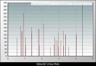

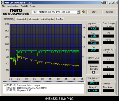

Stary 28.02.2007, 00:43   #76
Verbatim +Rx16 palony 18x Pioneer 112 1.09
Pioneer DVR-112\-212\-A12 \-S12-zapis-verbatim-rx16-18x-pioneer-112-1.09.png
Pioneer DVR-112\-212\-A12 \-S12-pxscan-verbatim-rx16-18x-pioneer-112-1.09.png
Pioneer DVR-112\-212\-A12 \-S12-plextools-xl-ta-1-verbatim-rx16-18x-pioneer-112-1.09.png
Pioneer DVR-112\-212\-A12 \-S12-plextools-xl-ta-2-verbatim-rx16-18x-pioneer-112-1.09.png
Pioneer DVR-112\-212\-A12 \-S12-plextools-xl-ta-3-verbatim-rx16-18x-pioneer-112-1.09.png
Pioneer DVR-112\-212\-A12 \-S12-transfer-verbatim-rx16-18x-pioneer-112-1.09.png
Jest bardzo dobrze.

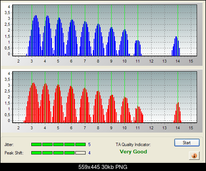

Stary 28.02.2007, 09:50   #77
Panasonic -Rx16 palony 18x Pioneer 112 1.09
Pioneer DVR-112\-212\-A12 \-S12-zapis-panasonic-rx16-18x-pioneer-112-1.09.png
Pioneer DVR-112\-212\-A12 \-S12-pxscan-panasonic-rx16-18x-pioneer-112-1.09.png
Pioneer DVR-112\-212\-A12 \-S12-plextools-xl-ta-1-panasonic-rx16-18x-pioneer-112-1.09.png
Pioneer DVR-112\-212\-A12 \-S12-plextools-xl-ta-2-panasonic-rx16-18x-pioneer-112-1.09.png
Pioneer DVR-112\-212\-A12 \-S12-plextools-xl-ta-3-panasonic-rx16-18x-pioneer-112-1.09.png

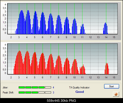

Stary 28.02.2007, 13:12   #79

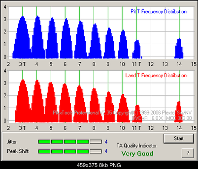

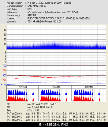

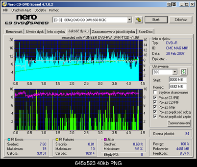

TDK +Rx16 palony 12x (max prędkość) Pioneer 112 1.09
Pioneer DVR-112\-212\-A12 \-S12-plextools-xl-ta-1-tdk-rx16-12x-pioneer-112-1.09.png
Pioneer DVR-112\-212\-A12 \-S12-plextools-xl-ta-2-tdk-rx16-12x-pioneer-112-1.09.png
Pioneer DVR-112\-212\-A12 \-S12-plextools-xl-ta-3-tdk-rx16-12x-pioneer-112-1.09.png
@slawekj czy mógłbyś dodać wpis TA do opcji PxScan, interesują mnie wartości liczbowe tego parametru.

Stary 28.02.2007, 18:34   #82
Philips +Rx16 palony 12x (max prędkość) Pioneer 112 1.09
Pioneer DVR-112\-212\-A12 \-S12-pxscan-philips-rx16-12x-pioneer-112-1.09.png
Pioneer DVR-112\-212\-A12 \-S12-plextools-xl-ta-1-philips-rx16-12x-pioneer-112-1.09.png
Pioneer DVR-112\-212\-A12 \-S12-plextools-xl-ta-2-philips-rx16-12x-pioneer-112-1.09.png
Pioneer DVR-112\-212\-A12 \-S12-plextools-xl-ta-3-philips-rx16-12x-pioneer-112-1.09.png

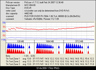

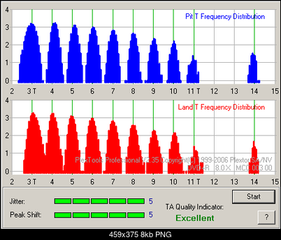

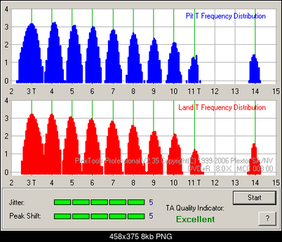

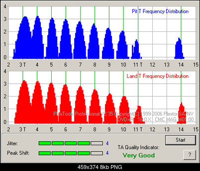

Verbatim +Rx16 palony 18x Pioneer 112 1.29
Pioneer DVR-112\-212\-A12 \-S12-pxscan-panasonic-mcc-rx16-18x-pioneer-112-1.09.png
Pioneer DVR-112\-212\-A12 \-S12-plextools-xl-ta-1-verbatim-mcc-rx16-18x-pioneer-112-1.09.png
Pioneer DVR-112\-212\-A12 \-S12-plextools-xl-ta-2-verbatim-mcc-rx16-18x-pioneer-112-1.09.png
Pioneer DVR-112\-212\-A12 \-S12-plextools-xl-ta-3-verbatim-mcc-rx16-18x-pioneer-112-1.09.png

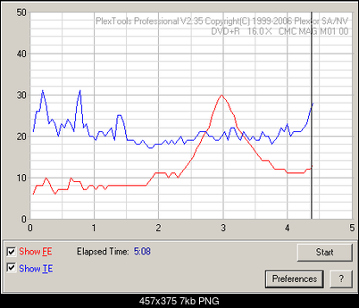

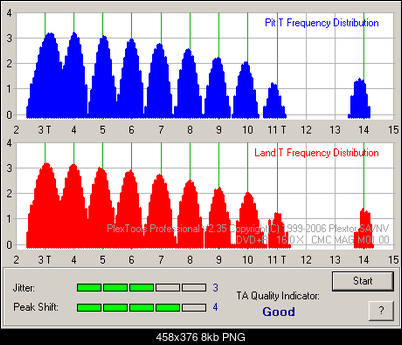

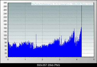

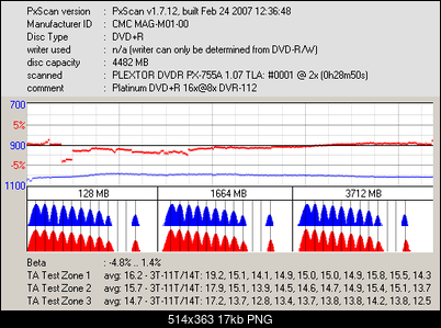

Platinum DVD+R 16x
Chcesz nagrać dane wrogowi - Platinum idealnie się do tego nadaje
BURN 8x
FE/TE :
Zapis :
Disc quality :
PxScan :
TA wew. :
TA śr. :
TA zew. :
Jednak 112-ka sobie poradziła

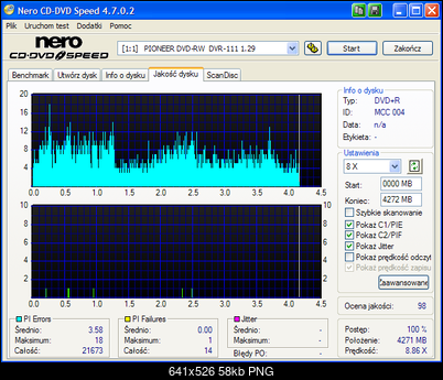

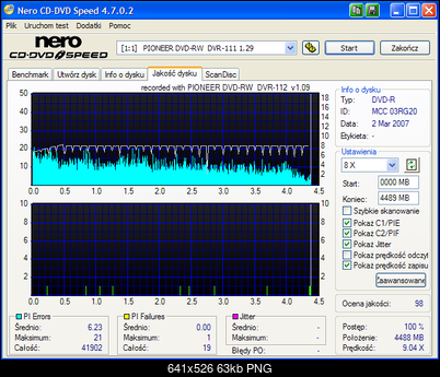

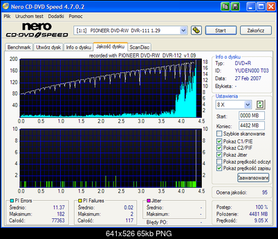

Czas na ekstremalne testy.
Kolejno wszytkie płytki testowane na Pioneerze 111@A11XL
Pioneer DVR-112\-212\-A12 \-S12-nero-cd-dvd-speed-verbatim-rx16-18x-pioneer-112-1.09.png
Pioneer DVR-112\-212\-A12 \-S12-nero-cd-dvd-speed-panasonic-rx16-18x-pioneer-112-1.09.png
Pioneer DVR-112\-212\-A12 \-S12-nero-cd-dvd-speed-tdk-rx16-12x-pioneer-112-1.09.png
Pioneer DVR-112\-212\-A12 \-S12-nero-cd-dvd-speed-philips-rx16-12x-pioneer-112-1.09.png

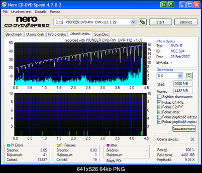

Verbatim +Rx16 ( MCC 004) palony 18x
Pioneer DVR-112\-212\-A12 \-S12-nero-cd-dvd-speed-verbatim-mcc-rx16-18x-pioneer-112-1.09.png
