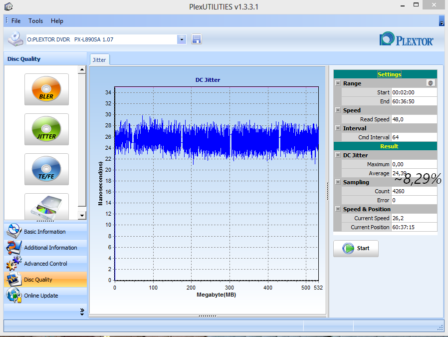

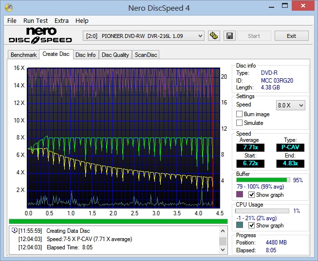

Stary 23.03.2015, 16:57   #345
Posty: 22,761
Fortis CD-R Made in Tajwan CMC 97m26s66f
Pioneer DVR-116 fw.1.09
Nero 2015 x 16
