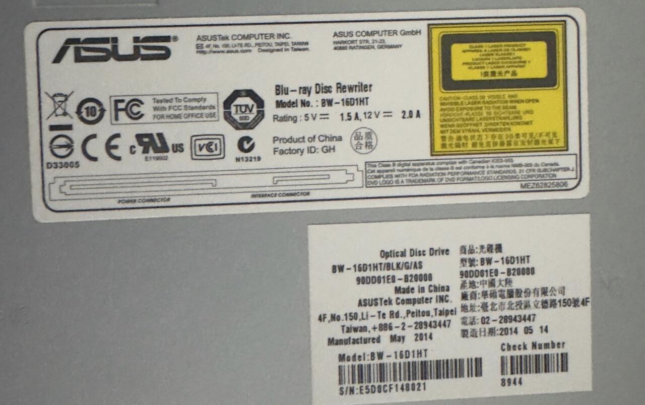

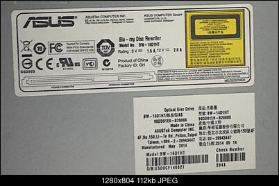

Question crossflash Asus BW-16D1HT to Vinpower WH16NS48?
Sorry for writing directly in english and for this kind of crossposting, but since when Cdfreaks/Myce closed (i was a member there too) this is the only old-school forum where these kind of informations are available.
So, I'm looking for softwares and firmwares to crossflash my Asus BW-16D1HT into a Vinpower LG (to have something more updated and to make error scan). My Asus was made in May 2014 so i think i've to crossflash to WH16NS48, not the NS58, am i right?
I've looked here Asus BW-16D1HT - zanim zamienię go w cegłę... and here: Crossflash BluRay LG\ ASUS-Asus BW-\12B1ST "a"\14D1XT\BW16D1HT-LG BH14NS40 \ BH16NS40 but could find what i was looking for
Can anyone help me woth those files and some help? Thanks in advance

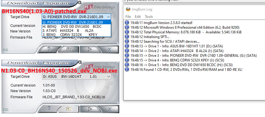

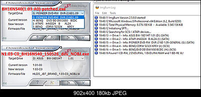

thanks to czary2mary i got flash_HL-DT-ST_BD-RE_WH16NS48_1.D3.bin and BH16NS40(1.03-A0)-patched.exe from here https://www.szybkiplik.pl/hmcYr8UELh
I tried "BH16NS40(1.03-A0)-patched.exe" on windows 10 and windows 7 (x64) and with both it doesn't recognize my Asus Bw-16d1ht, while another LG updater ( N1.03-C0_BH16NS40_150526_dev_NOBJ.exe ) does see my asus
Am i doing something wrong? what should i do? should i try to use N1.03-C0_BH16NS40_150526_dev_NOBJ.exe first and then BH16NS40(1.03-A0)-patched.exe ? (i don't want to risk too much cause i don't even have original ASUS firmware in bin format and cause i don't want to flash to the wrong firmware)

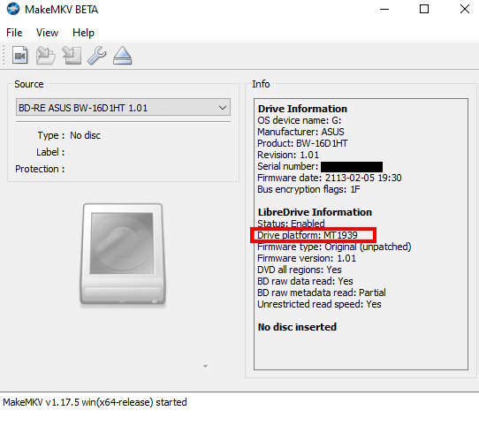

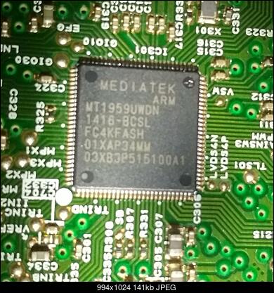

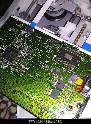

unfortunately i've still not succeeded.

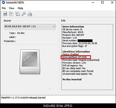

i tried sdftool with MakeMKV but the program says i have 16dh1t with MT1939 and it should be MT1959. So sdftool flasher doesn't work either (it says something like "it's not the correct chipset" )
i disassembled the burner and the chipset is marked as MT1959UWDN 1416-BCSL FC4KFASH
So why makemkv says it's a mt1939 chipset? what should i do now?

3) sdftool with makemkv doesn't flash firmware cause it says i have the wrong chipset (MT1939)

rozebrałem palnik i chipset ma oznaczenie MT1959UWDN 1416-BCSL FC4kFASH
Dlaczego więc makemkv twierdzi, że to chipset mt1939? co mam teraz zrobić?

The problems are probably caused by this different hardware. I don't know why you have a different chipset in this equipment... I've never seen anything like this in this Asus/LG model...

To be honest, this is the first time I have seen such a case in this design... Production date: 2014.
I have no idea why it is like this - especially since the mt1959 chipset is at least 2015/2016 released...
Maybe it's a warranty unit that was repaired at the service center and has already received a newer version of the motherboard... The design of the motherboard comes from this design.

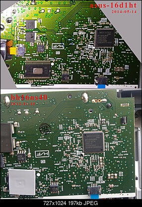

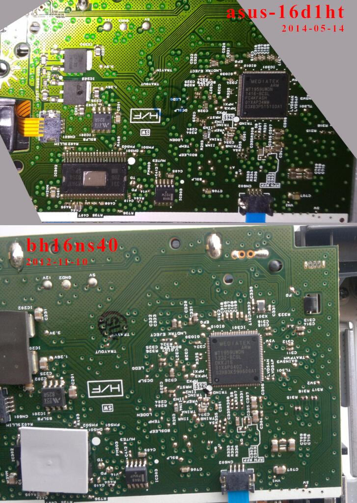

i searched the forum to find an image of a BH16ns40 from 2012, doesn't it look the same as my Asus 16dh1t (with the same MT1959UWDN chipset) ?

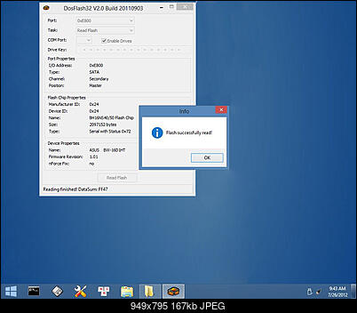

i connected the asus 16dh1t to an old p5b-dx with intel sata controller in ide mode. i used a dvd+r live WinPE of Win8 32bit and used dosflash v2.0 to read the flash and it seems that it worked. the result is in the pic appended.
am i doing everything correctly? (i'll follow this guide: DosFlash V2.0 patched to support BH16NS40/BH16NS55 drives )
could i try to write VinPower flash_HL-DT-ST_BD-RE_WH16NS48_1.D3.bin without brickin it? or is it too risky?

Yes - you can try to upload the firmware from VinPower - hopefully it will be fine.
If it doesn't work well, restore/upload a copy of the firmware made with DosFlash V.2.0 of the Asus software

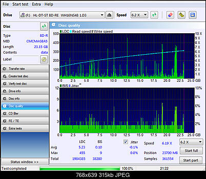

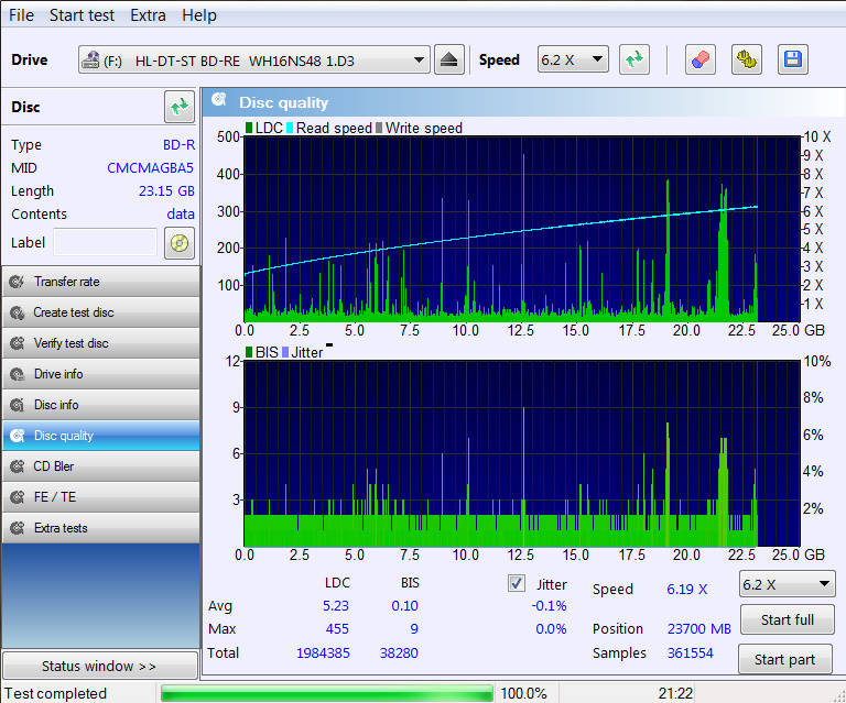

Thanks a lot czary2mary. I tried to write the firmware with Dosflash v2.0 and it seems that it worked!!
My Asus BW-16D1HT is now recognized by Win7 x64 as a WH16NS48 1.D3, it can read BDr and DVDr, and it does BDr disc quality, not sure if it burns BD/DVD well cause i haven't tried it yet but i hope there won't be any kind of problem.
Now i'll check WH16NS48 thread to see how it works better (what are its best disc-quality read speed and CMCMAG5 write speed)
Thanks again czary2mary, have a great Holiday
